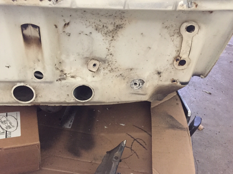

i need advice on how to mount the fog lights on the early bumper conversions like this- i have super nice OEM NOS lights to put in- those grills came from 914rubber, and thr bumper came from Noel in CA, it really needs some hammering and a rechrome job, but i have that early one with no bumper guard holes which i lime the look of better but i think i need to keep the bumper guard one on for driving around with-- oh and another question, how. do you attach the fog light grill? 4 holes in corner, what size bolts/screws??

Skip the tits. Usually it's taps on the rear, not the front. Do the later cars have the dimples in the front fascia where the round fogs mount?

Jul 12 2018, 08:06 AM
QUOTE(rhodyguy @ Jul 12 2018, 09:17 AM)
I think so, if someone can take a picture of their body area under the bumper on an earlier car it would help - so it could be as easy as drilling the mount hole at that location or is there a tab that should be there? on the late ones it mounted directly to the bumper.
rhodyguy
Jul 12 2018, 08:10 AM
Just holes with nuts welded to the back side. Guys use captured nuts? in the new holes. Riv nuts?
DRPHIL914
Jul 12 2018, 08:13 AM
where would the spot be ?
Shadowfax
Jul 12 2018, 09:30 AM
Phil - I’ve got my car apart and will take a pic of the front, specifically the fog light area, for you during my lunch break.

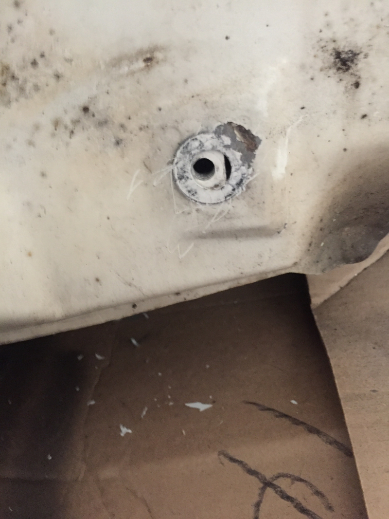

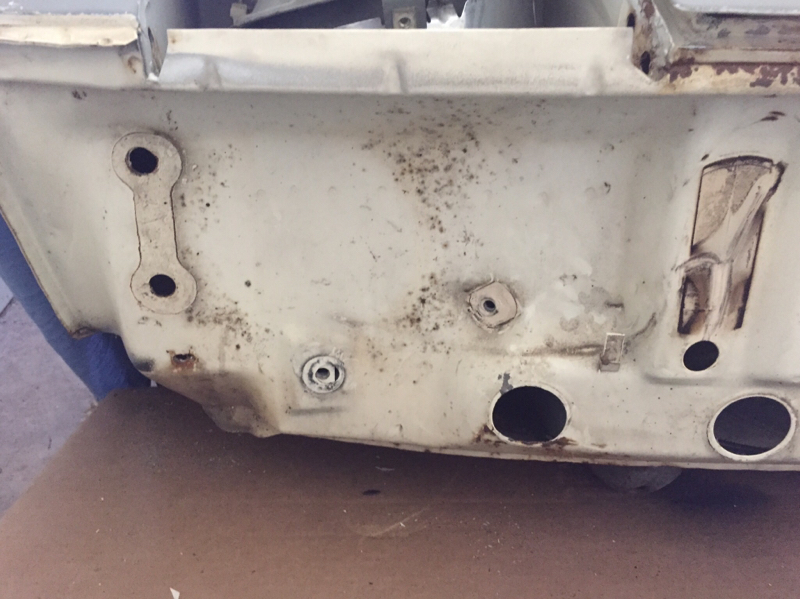

Jul 12 2018, 10:57 AM
Here you go. Sorry for the bad pics. I’m a terrible photographer :
First one shows driver’s side, next is passenger side and last one shows the captive nut for the fog light bolt. The hole that sits higher and just above one of the body holes is for the horn.
Click to view attachment Click to view attachmentClick to view attachment
DRPHIL914
Jul 12 2018, 12:12 PM
looks like the spot that sticks out slightly is still there even though there are a few differences in the early Vs late panel, but I think I can do a mock up and see if that mounts up and aligns up, - my horn was on the under side on the 75, the mount bold rusted off on the driver side though so I will now mount it under the bumper just like you had on yours, I will just have to drill another hole ugh! wish I had done that when I did the bumper mount holes before the paint was applied.
