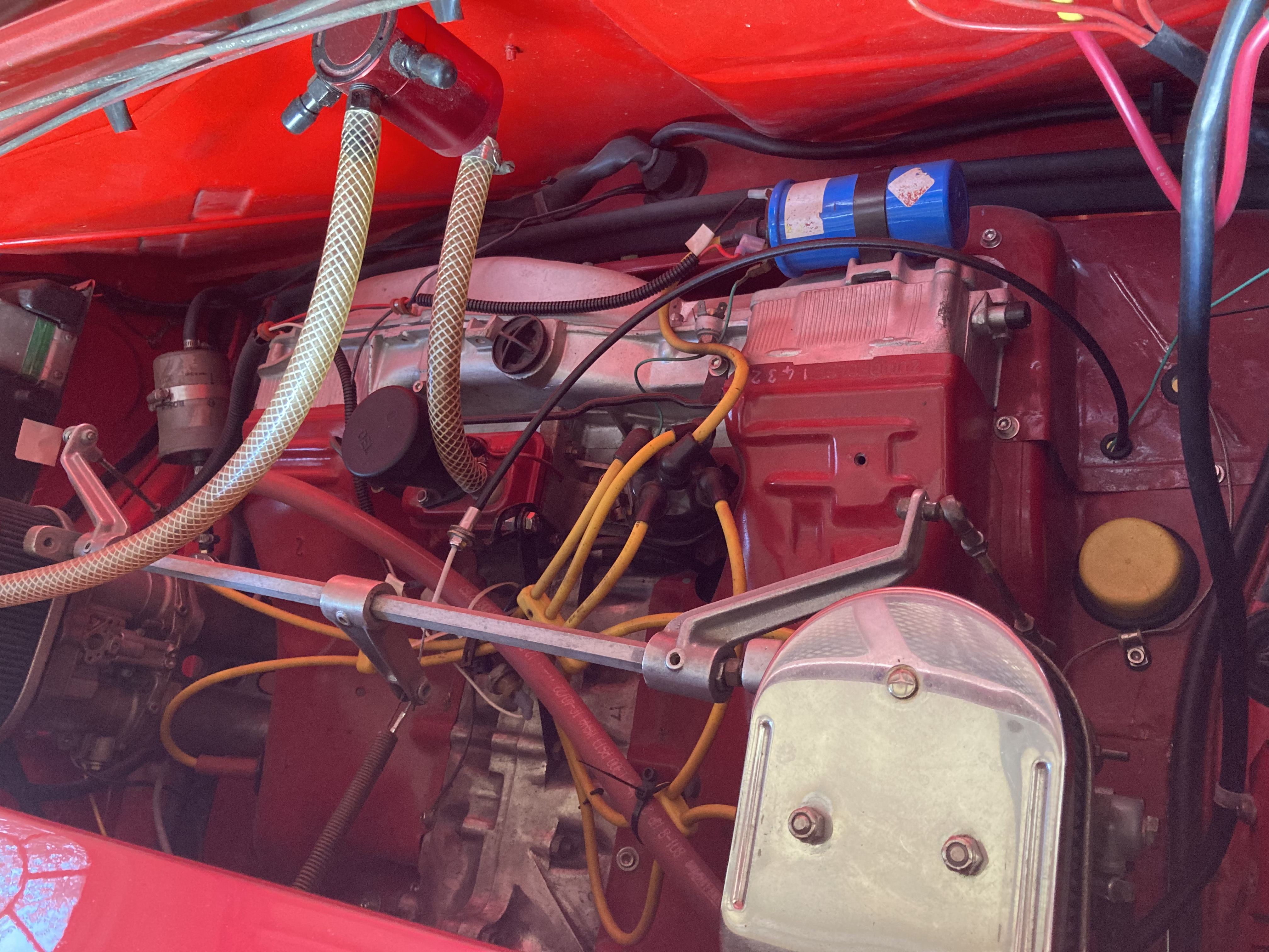

Sep 20 2021, 07:01 AM
it’s been a week since my last post to update this ,
i jd the other thread about the CV issue, ans with that complete i was able to get the motor mounted in the car and wiring installed, also fuel lines etc. Saturday we primed it , fort oil pressure so hooked up the fuel lines and injectors and did the first start up.
It is now a running car! Sunday i did a run around the neighborhood, 2 20 minute runs for break in, and some tuning. idle is high and i think it’s an issue with vac hose hook up, this motor has head vents ans i was going off of factory diagram but several people suggested i hook up the head vent ans the oil filler vent to a breather box/catch can. any input on this would be appreciated- i will post a few pics but it’s installed per factory diagram from Jeff Bowlsby website.
nditiz1
Sep 20 2021, 07:25 AM
Nice work! I would go with that same idea. Mount a box to the firewall and have all 3 terminate at the breather. Cap off the one hole that would be used for the oil filler to the air box.
Where did you source your ebrake cables and boots? I need to redo both of mine.
DRPHIL914
Sep 20 2021, 07:51 AM
QUOTE(nditiz1 @ Sep 20 2021, 09:25 AM)
@nditiz1 thanks for the input. yea, hooked up like this, the breather goes to the manifold/plenum which sucks a lot of air and is like a giant vac leak, before with original 75 motor that had the smog removed , no head vents the breather just went to the air box, not plenum. but like that its going to suck oil vapor and mess up the box and the hoses. I was told by an experienced VW and Porsche motor builder that doing it with the catch can box will balance the pressure, not suck those oil vapor into the box and decrease the carbon build up on the valves too. IDK but i am going to make that change and see how that does.
- also the E-brake cables came from E-bay, but the boots are either 914rubber or SMC i am not sure.
I have my other cables i had installed about 5 years ago, they are fine and just had a bit of overspray on them and a bit of rubbing on one of the sheaths. if you want them i can give them to you at Okteenerfest, let me know. i will bring them with, will trade for a bottle of Hendricks Gin or a nice Bourbon lol.
Phil
barefoot
Sep 20 2021, 08:05 AM
QUOTE(DRPHIL914 @ Sep 20 2021, 09:01 AM)
I connected the head vents to themselves & a small breather catch can mounted high on firewall to vent the chimney to a carb inlet. NB I stuffed some open cell reticulated foam in the breather can. These hoses stay dry, no oil collection observed.
Not sure where with FI you would connect vent hose.
