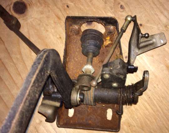

Received my Manual throttle assembly from 914 Rubber and it looks great! But no specific instruction regarding the “Shark Fin” and I have not seen a real one up close. I understand where and how the lever and rod go that's no problem.
Did some poking around here on the site (IMG:style_emoticons/default/type.gif) where I thought I might see pictures but I did not see the small “shark fin” and how and where exactly it goes on the gas pedal. (IMG:style_emoticons/default/idea.gif)
Does anybody have a good picture of the "Shark Fin" installed either real original 914-6 or 914 Rubber version?
Of course I had just got all the pedal cables hooked up and adjusted when I received the assembly not understanding how the hand throttle actually worked. I’m thinking the whole pedal assembly has to come out. (IMG:style_emoticons/default/confused24.gif)
“Shark Fin” is on the far left. Thanks!

Here's the "shark fin" welded on to the pedal throttle arm.
Clear as mud? (IMG:style_emoticons/default/smile.gif)
And yes....likely easier to take the whole pedal assembly out to do this.

Jim,good description of the shape (IMG:style_emoticons/default/biggrin.gif) ,I mounted this plate with one bolt and moved it once till contact with the rod ,the bolt out and plug welded the hole .
Every "6" on carbs should have one of these ,very handy for quick start up,I do 2-3 pumps on the pedal with the lever on full travel,mine starts straight up.

Thank you, (IMG:style_emoticons/default/beerchug.gif) thank you (IMG:style_emoticons/default/beerchug.gif) , thank you (IMG:style_emoticons/default/beerchug.gif) ! A picture is worth a thousand words.
I would have certainly have put it upside down having no clue which way the shark was swimming, but your picture says it all! (IMG:style_emoticons/default/first.gif)

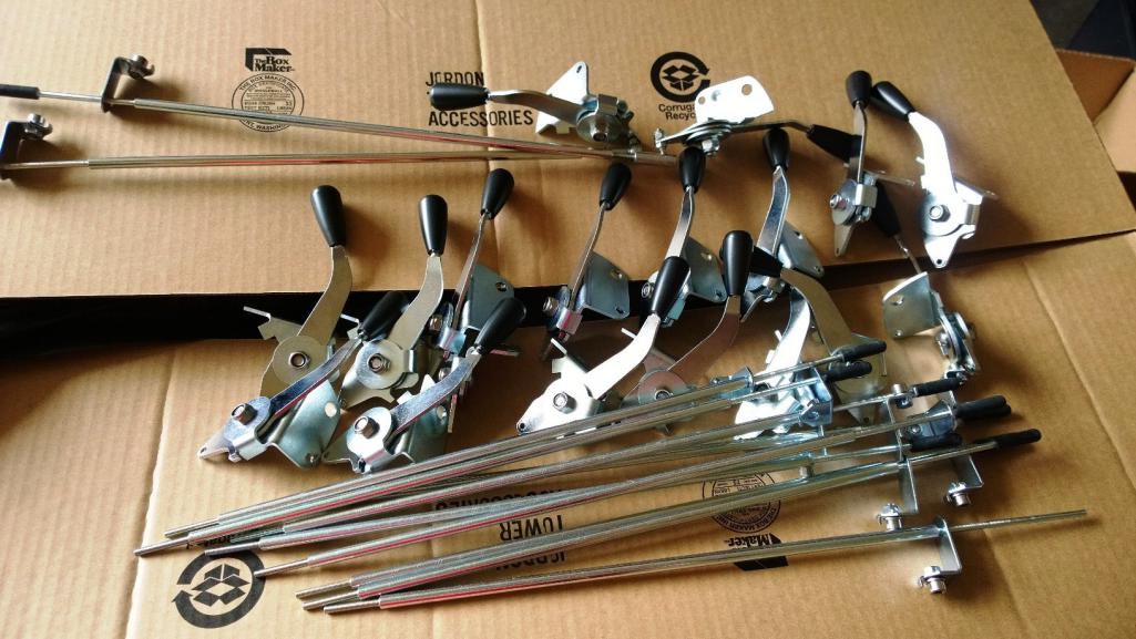

Agree! I was surprised at what I received as the picture on 914 Rubber did not show the "Shark Fin" or mention there was welding involved, or drilling and bolting, as the case may be. Also agree it would have been great to have the thing all ready to install. Perhaps in the future.
(IMG:style_emoticons/default/white914.jpg)
Picture from 914 Rubber site.

Here you go, I tucked the corner of the wood template into the leaver on the point where the flange changes direction
I assume 914 rubbers fin is exactly the same dim / shape. Looks very similar
Real fin has a dimple for strength / held on with a couple of small spotwelds
All dims in MM, dimension to the other fins corner is 55mm

here it is on a complete assembly.

QUOTE(SixerJ @ Nov 1 2017, 01:34 PM) *
Perfect illustration.

Here's the drawing I have.
We colorized if on the site to try to make it more clear. Matt may have some pics, nit sure if he has completed the install yet.

QUOTE(SixerJ @ Nov 1 2017, 10:34 AM) *
Thank you most helpful! (IMG:style_emoticons/default/beerchug.gif) This REALLY is what is needed! (IMG:style_emoticons/default/smilie_pokal.gif)
