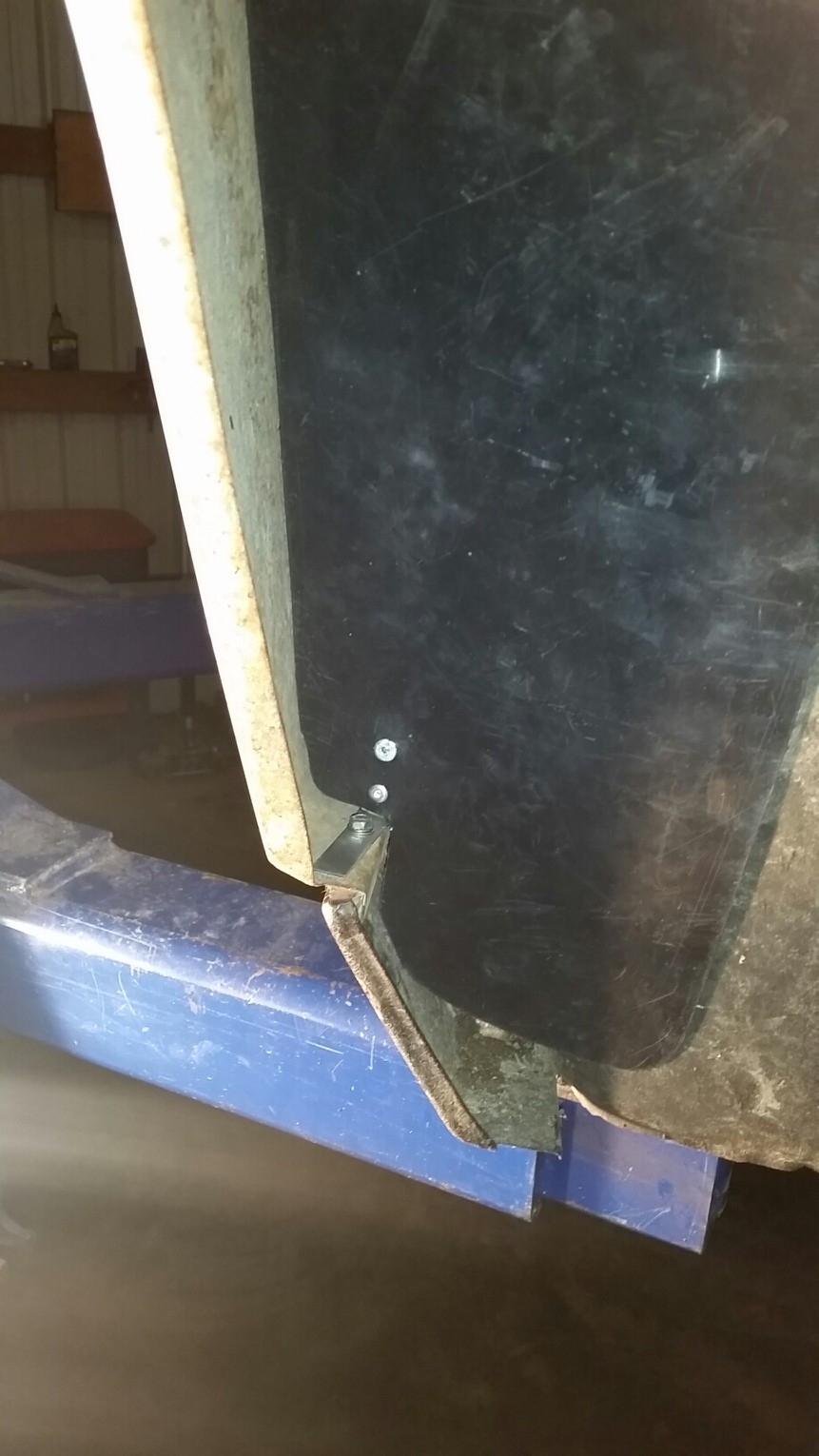

Crash Course : The wide one goes it the back.
Step one, attach the mounts. The front I had the liner flush with the fender lip. The rear I had back up tight against the inner fender.
Now flex the liner into place.
Then bow the liner behind the mount to allow you to drill the 1/8" holes.

Pretty simple. Drill the holes and rivet it in. Keep an eye on the location of the liner in the arch. It wants to slide up, and you want to keep it tight and tidy against the fender.
Front fender is more of the same.
These were installed without any trimming or tuning of the liner.

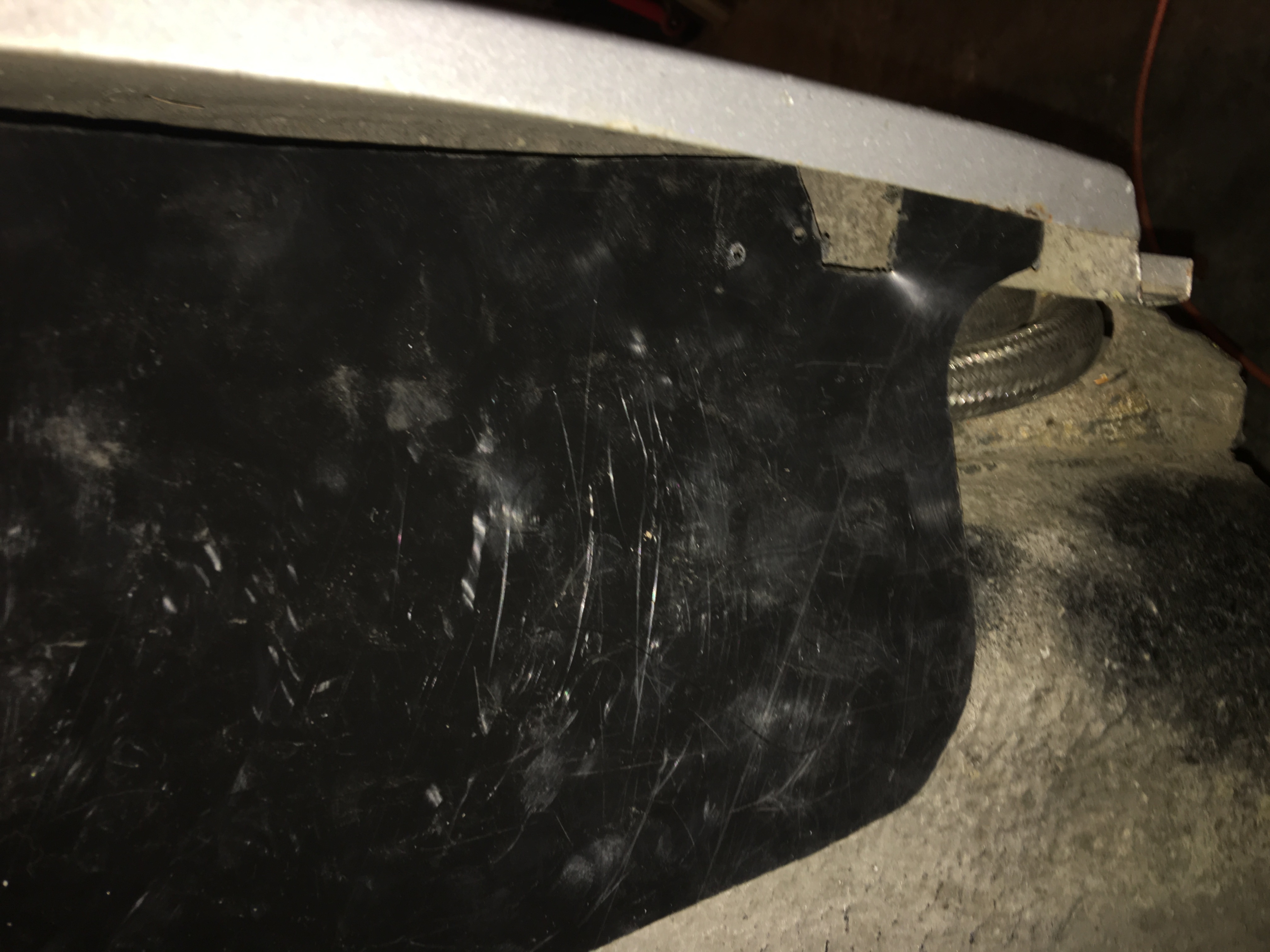

Thanks Cory for all the valuable info. Is this a front or rear? I am guessing it is a front, but where does that little tab on the end go? It seems to interfere wherever it goes. The front of that piece is slightly notched for the fender but the tab is a mystery.

Here is my misguided attempt to try to make the piece which matches the one above fit in the back of the front wheel well. I notched it but it still won’t snug up to the fender.
You can see the issue with that tongue piece.
When flush mounting the liners against the fender lips how can you access the bolts which mount the L brackets when you want to drop a valence or the rocker panel?

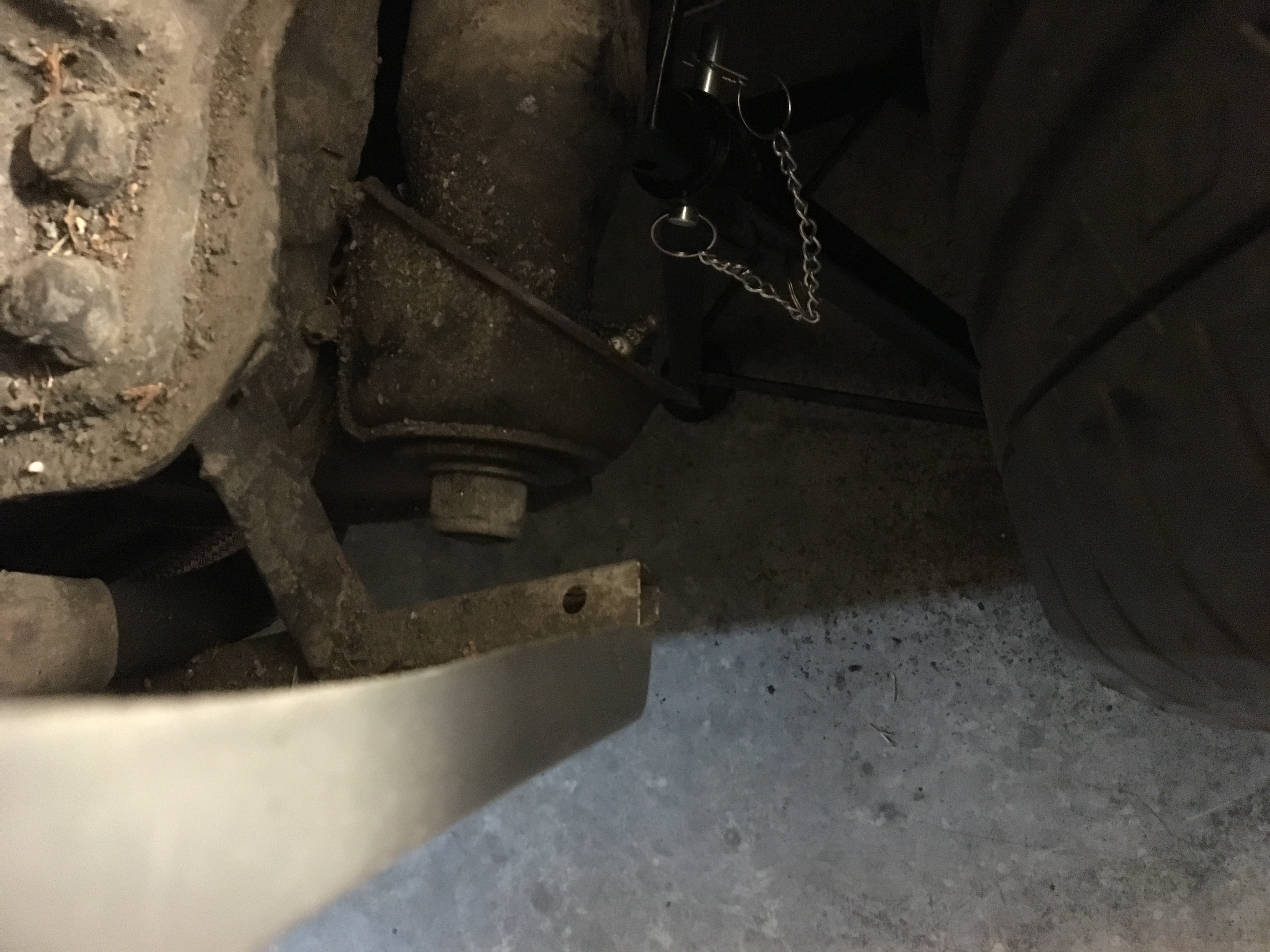

Here is the clearance issue with mounting the rear There just doesn’t seem to be room to fit the liner with the bracket since it hits the suspension. Also how do you get to the zirk with the liner in place?
if the solution is to mount the L bracket on the inside, how do you access the bolt to remove the rocker without drilling out the rivers? I am repainting the rockers and was going to put them on last.

That's the rear.

Here's the tab on the left rear. You can see the little tab / tongue right in front of the rear
trailing arm.

post Dec 10 2017, 12:06 AM
Posts: 3,900
Joined: 26-January 04
From: Sherwood Oregon
Member No.: 1,608
QUOTE(RickS @ Dec 9 2017, 07:20 PM) *
Drilling out the rivets will always be the easiest way out. 1/8" drill bit and they pop right off. I've always had the advantage of having the car up on a lift. Giving me more access.
