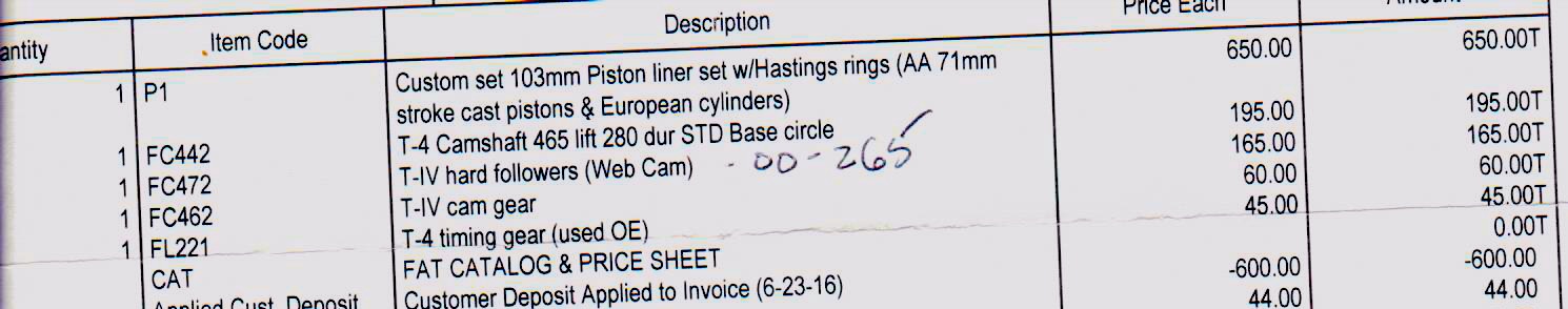

Yes, it wasn't a cheap visit for me either: $400 for several runs and some tuning. They didn't charge me for noticing the VW shop had forgotten to screw down the main jet stack on one of my new DRLA 45s.
For what it's worth, here's what the previous owner used:
