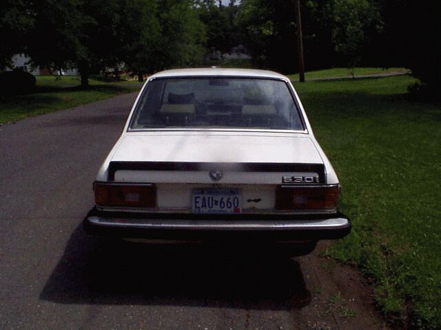

That's pretty pricey - I just picked up an 89 325is for 2K. 175,000 miles, 2 owner - religiously maintained. It's still a solid car, but I'm doing some looking over it to make sure everything is up to snuff.
I think the rear end is a little loose, like there is some slop in the R/P.
They made 168hp at the flywheel out of the factory. That's a hotrod to get that much at the rear wheels...
