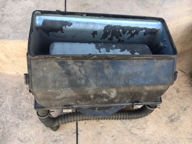

Here's a pic of the airbox after cleanup. This had paint all over it before.

even just sitting there on a rug, the air box taunts with its evil ways

QUOTE(cuddy_k @ Mar 28 2018, 09:18 PM) *
(IMG:style_emoticons/default/lol-2.gif) Yeah, not looking forward to putting that back in the car.

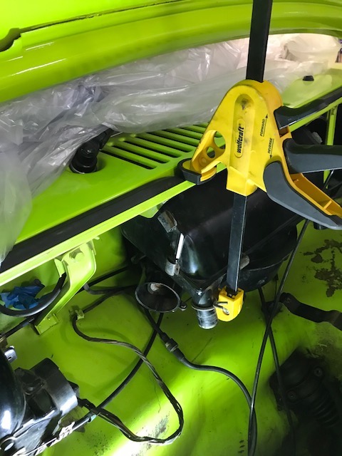

A clamp reduces f-bomb use by at least 50%. Also way easier with the tank out
