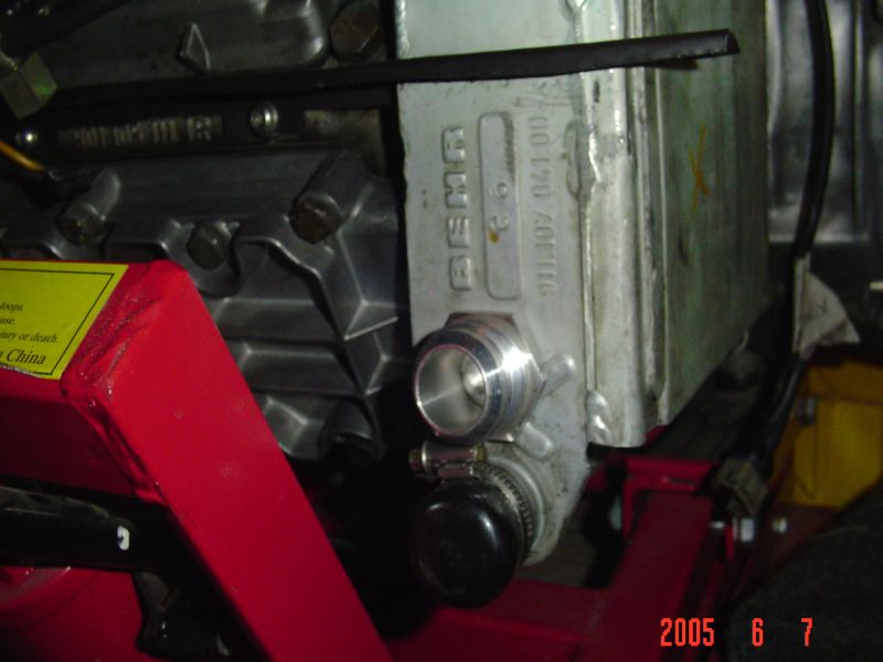

Very good info, Thanks! So - there's no problem in reducing an AN-16 (or -12 for that matter) to this adapter? (It'll be attached to the cooler).... It's smaller than the larger of my two lines. AND I don't know the thread count but I assume it's AN.

oops, forgot the picture.

don't ass-u-me and the thread count is not helpful. IIRC, 45-degree SAE fittings (naturally...) use the same sizes but the flare angles are NOT compatible with AN's 37-deg. find a KNOWN AN male fitting and compare flare angles.
that fitting looked awful small... if the ID of the fitting is smaller than AN-12's nominal ID, it's not gonna flow enough oil...
i'm confused on what you're doing with adapters and such - what is the actual connection to the cooler - and what kind of cooler is it?
and while you may be able to get adapters, stepping down from big lines to teeny ports is not going to get you the effect you need...

Here's a better pic of the adapter.. I'll be using it to attach the AN (prob -12) hose from the oil tank to the on board oil cooler, as you can see in the pic. I will be using a 90degree AN fitting to connect the two.

BTW, I just set that thing on top of the stock (unmodified) slip-on cooler in-let, in the picture.

QUOTE (DougC @ Jun 7 2005, 03:51 PM)
okay - just so we're clear...
that -is- the suction line to the inlet of the pressure pump.
it kinda looks like it might have something to do with the oil cooler, but the oil cooler is just a fancy mounting bracket for the little pipe that runs under the cooler that connects that fitting to the inlet of the pressure pump.
and before you commit to attaching a straight bumg to the cooler and using a 90* fitting, v-e-r-y carefully measure the amount of clearance available.
and have a look in a couple of the other threads going on right now about /6 cooler fittings - because there is VERY LITTLE clearance bewtwen the cooler outlet and the suspension in that area. that's the big reason why people use angled weld fittings. the OEM 914.6 cooler is different from the 911 cooler for this very reason...
