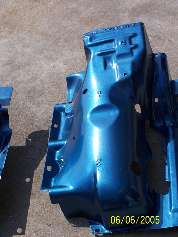

> Mmmmm engine pr0n..., Dirty old black engine tin

Brando
post Jun 9 2005, 11:16 PM
BUY MY SPARE KIDNEY!!!
Posts: 3,935
Joined: 29-August 04
From: Santa Ana, CA
Member No.: 2,648
side view...

front (rear?) shot:

'nother side:

powder coat? and did you do all the other pieces too? (IMG:http://www.914world.com/bbs2/html/emoticons/beerchug.gif)

Misc. holes like this will be plugged with fancy black plugs held in my clear RTV.

Last one... I love the way that metallic blue shines.

QUOTE (Aaron Cox @ Jun 9 2005, 09:18 PM)
No powder coat... A&C would have wanted like $50, plus I don't have the other peices to be coated the same.
1 bottle of Jasco aircraft paint stripper (gel), one bottle of naval jelly, a metal-blackening kit from jasco, Rustoleum cold-galvanizing, rustoleum rust-prohibitive primer, two cans of metallic blue, one can ceramic clear-coat. Now I just have to polish and/or wax them a tad and they're ready to use. With a few minutes of minor shaping I was able to get rid of most of the dents and warping in the metal. Also ground off a few un-needed pieces to give them a cleaner look. Holes will be plugged with black plugs-- i didn't have any spare metal or oxy-acetelyne to weld them up.
what's the verdict? That cheapo engine tin sure polished up nice eh?

I'll be doing the same thing with Rustolium Hammercoat (?), I think that's what it's called. How did you de-grease them?

QUOTE (Dave Eddy @ Jun 10 2005, 05:25 AM)
Sweeet!!
2 rounds of Engine Foamy Brite, followed by a hard scrubbing of Simple Green with a wire brush.
