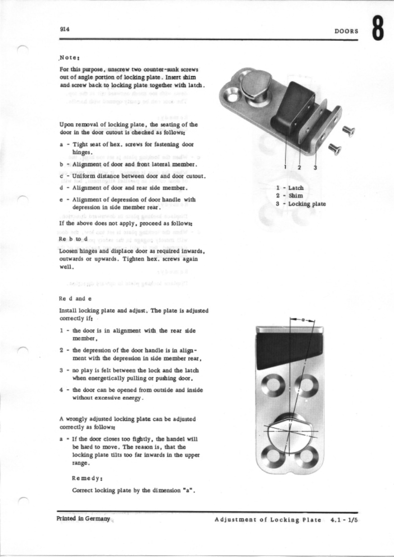

Loosened and reset the catch on the door jamb, working 90% better . Gonna take a closer look at the door height

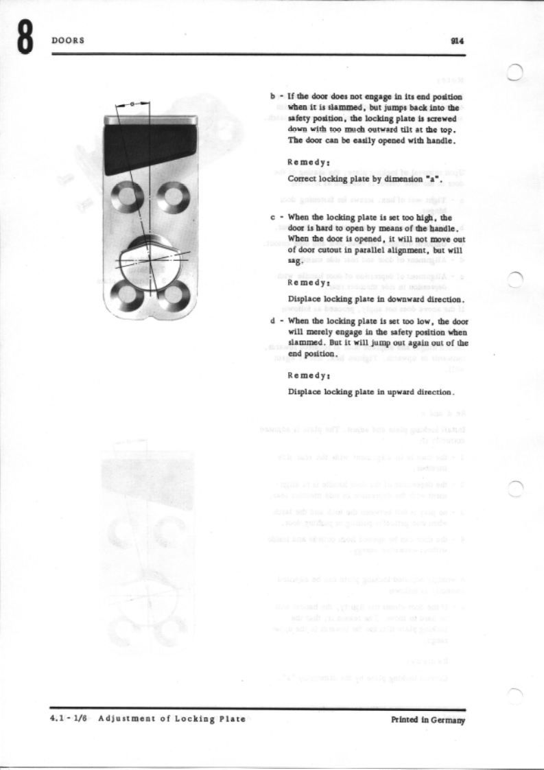

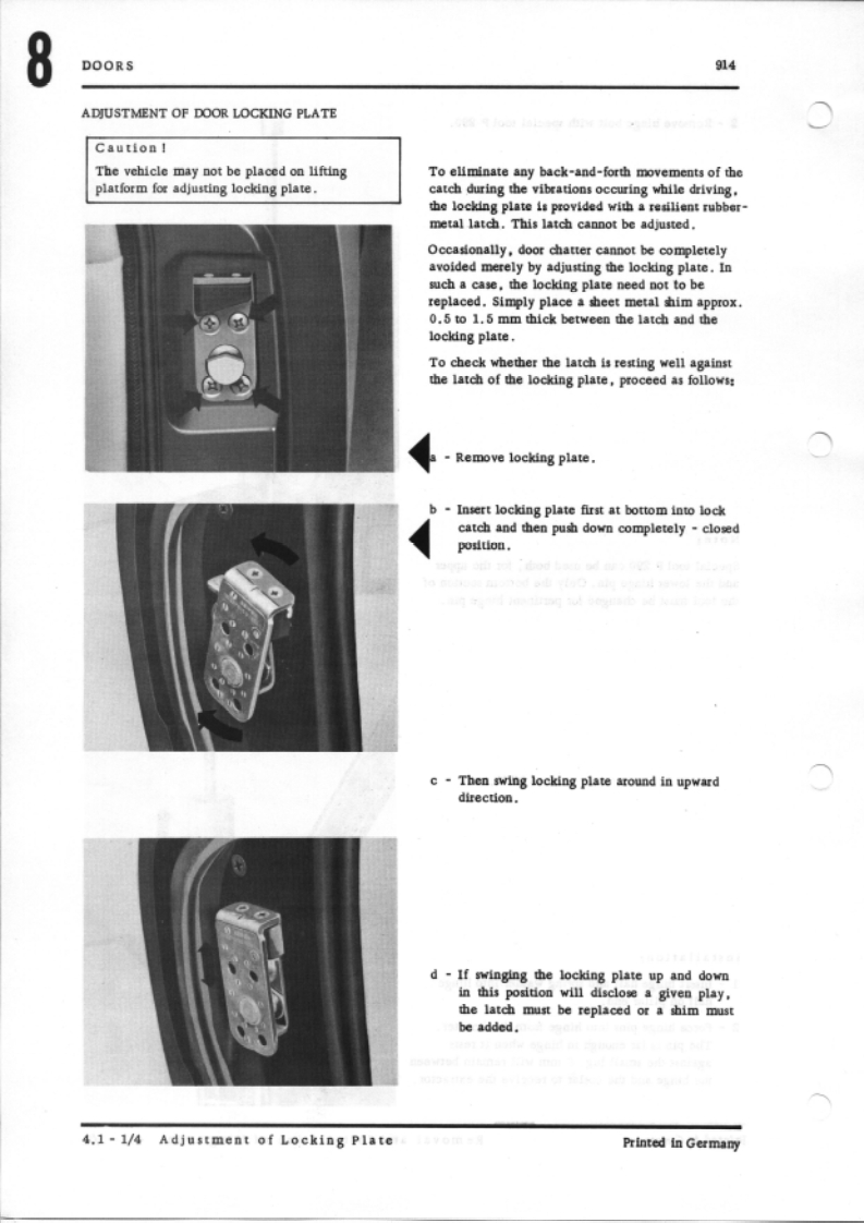

There is good info in the factory manual on adjusting the striker and it wasn't intuitive to me so might be worth a look. Here are some screen grabs. Maybe they will help? (IMG:style_emoticons/default/confused24.gif)

QUOTE(rhodyguy @ Jun 13 2018, 01:24 PM) *
Where is the rubber block that should be on the latch plate? Is the block there on the other side? The plate assem itself looks dif than the one in the manual pictures.
The rubber block is on the jamb part, not the door part ...
