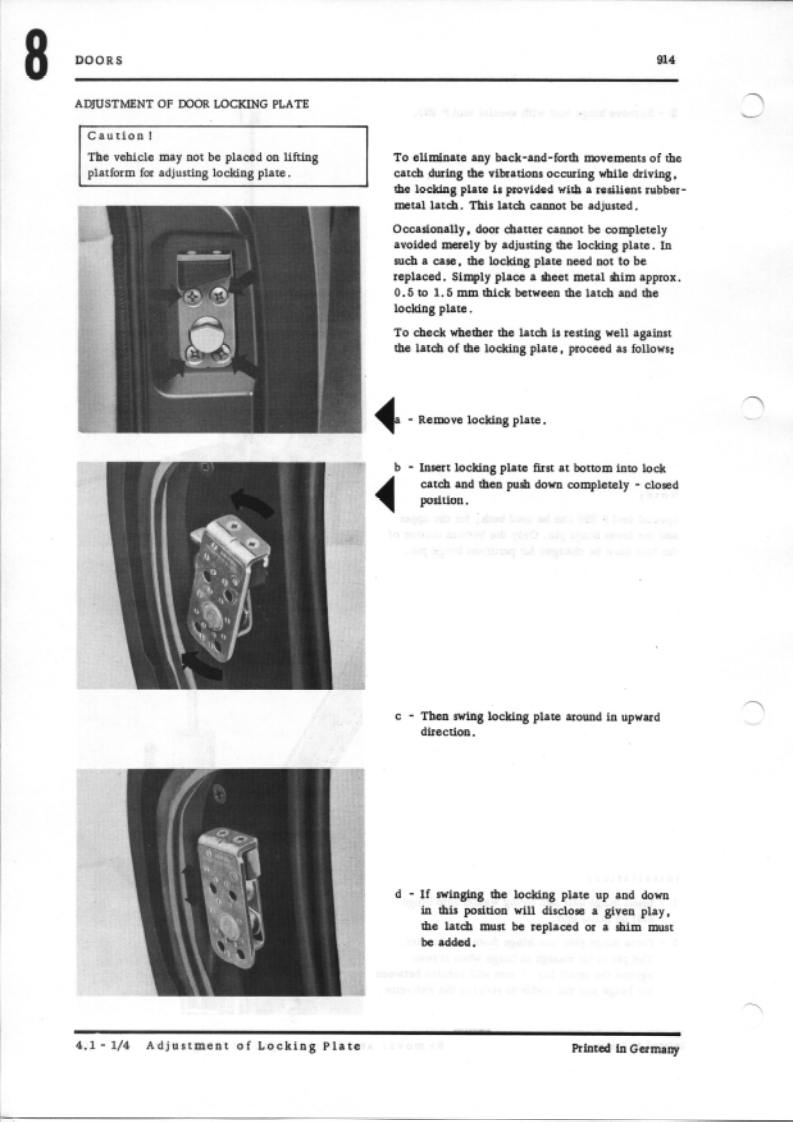

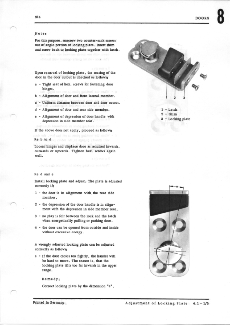

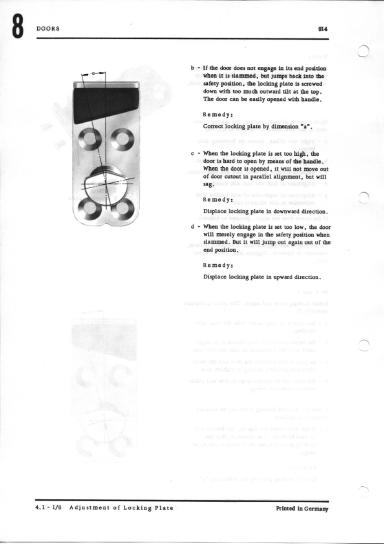

There is good info in the factory manual on adjusting the striker and it wasn't intuitive to me so might be worth a look. Here are some screen grabs. Maybe they will help? confused24.gif

Where is the rubber block that should be on the latch plate? Is the block there on the other side? The plate assem itself looks dif than the one in the manual pictures.
The rubber block is on the jamb part, not the door part ...
rhodyguy
Right. You captured it while I was editing. Senior moment. I suspect the latch plate and assem. The door should easily open with a finger thru the handle hole.
