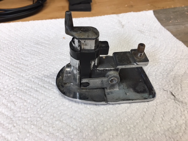

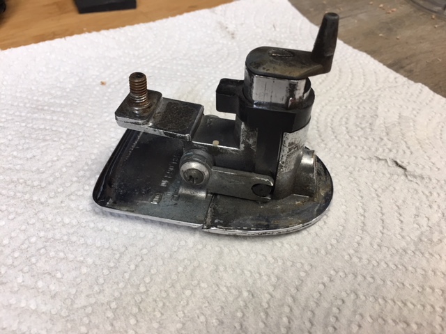

I’m helping SB914 get his passenger door handle to work. The interior pull works fine; the exterior pull will not work unless I push in on the door first.
Took the handle out; it’s ok
There’s not a lot of adjustment for the mechanism and i’m Trying to not remove it.
Anyone else had this problem ?

Jim,
The handle looks to be very dirty. It needs to be cleaned or otherwise it will stick.

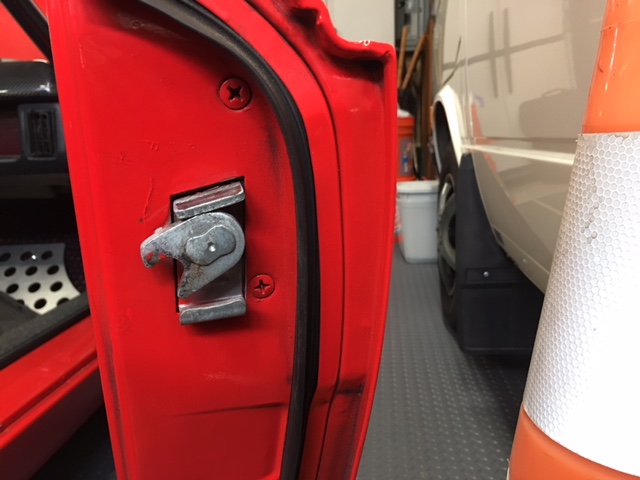

The striker plate....shown on the door is adjustable via the large screws in the jamb.

its been rebuilt. Notice that one side is a philips head the other still has a rivet~? not stock

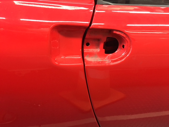

Your door looks like it needs to be adjusted. Sounds like the latch isn’t lining up and it is binding.

Thanks for those tips: I’ll clean the handle anyway. With the handle out of the door, I have push against the door to get the arm (?) on the mechanism to move and open the door.
Will try loosiening the screws that hold the mech. To the door and see if it helps.

Sounds like the plate that is on the door jamb needs adjusting.
That's the only thing that would explain why you have to push the door in before it opens.

The door gap sure looks tight. Also, the door could be moved up a couple of mm to match the rear quarter. That might give you a little bit of wiggle room.

Loosened and reset the catch on the door jamb, working 90% better . Gonna take a closer look at the door height

2nd clean the handle & make sure it's operating properly then reinstall it (you may want to make sure that phillips screw is tight - it may have been rebuilt, or maybe just the rivet popped-off/broke & the PO fixed with the screw, which may not hold properly & be causing the problem (see replacement options below)).

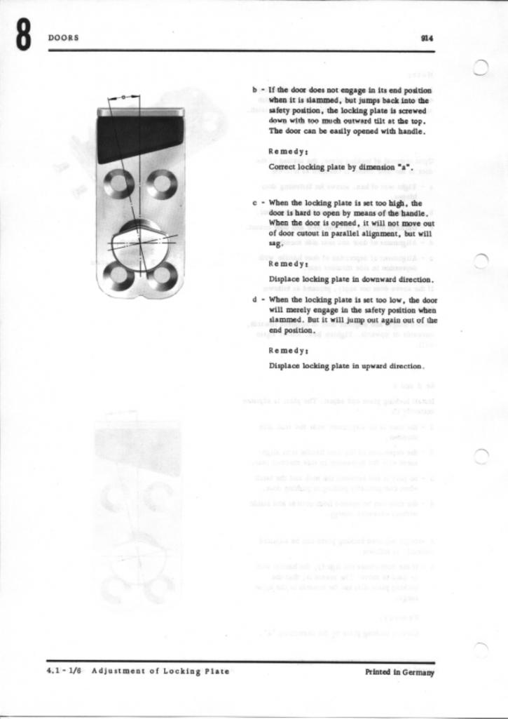

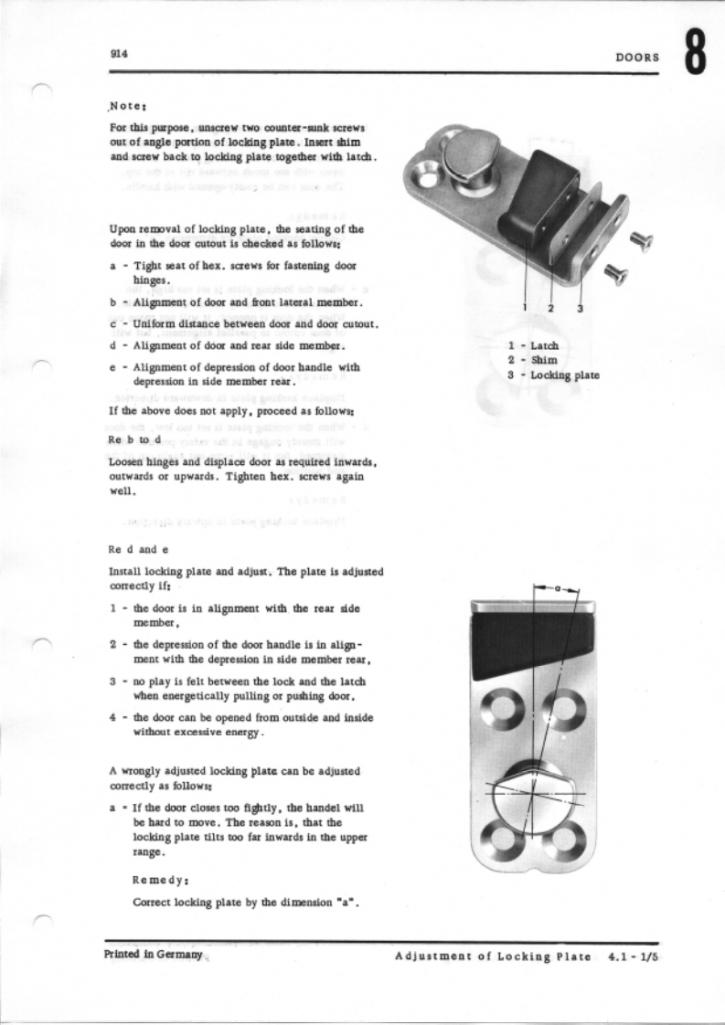

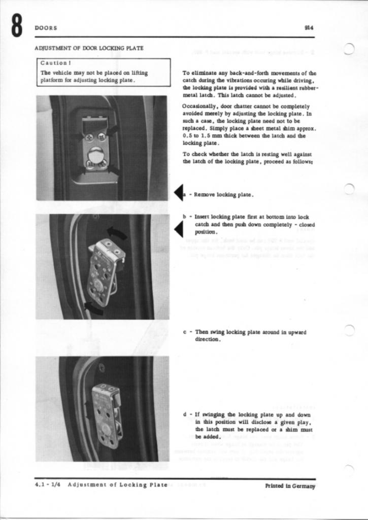

There is good info in the factory manual on adjusting the striker and it wasn't intuitive to me so might be worth a look. Here are some screen grabs. Maybe they will help? (IMG:style_emoticons/default/confused24.gif)

And... (IMG:style_emoticons/default/agree.gif) Looks like the whole door needs to be lifted at the hinges. That alone might cure the binding.

QUOTE(rhodyguy @ Jun 13 2018, 01:24 PM) *
Where is the rubber block that should be on the latch plate? Is the block there on the other side? The plate assem itself looks dif than the one in the manual pictures.
The rubber block is on the jamb part, not the door part ...
