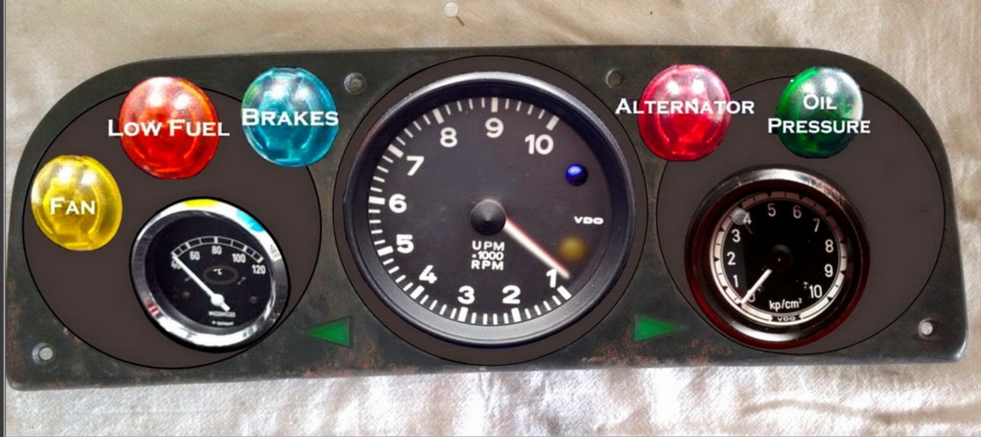

As an alternative they do sell in your face warning lights for op. They also make flashing LEDs. Our central nervous system is wired to notice changing things and ignore constant inputs.

If you're tracking the car, it's hard to hear anything over the induction and exhaust...mine's so loud I wear earplugs....a buzzer would never register. I added a bright red warning light up high on the instrument cluster.....look for "shift light" to get an idea....
