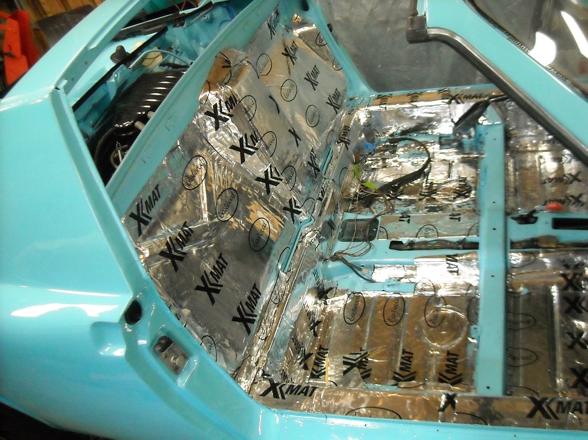

Used the X mat from Eastwood. Kind of like dynamat.
