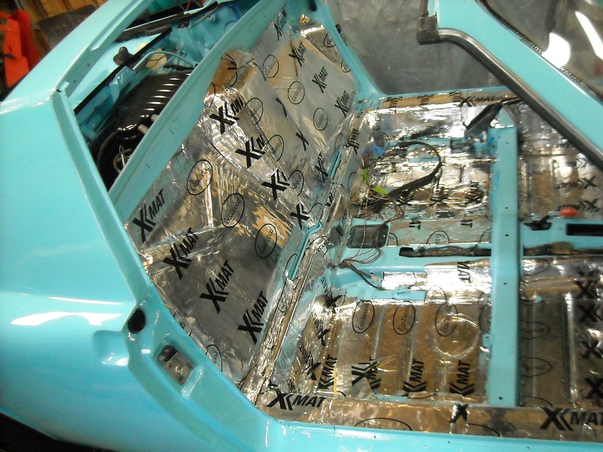

Jul 23 2018, 06:43 PM
Used the X mat from Eastwood. Kind of like dynamat.

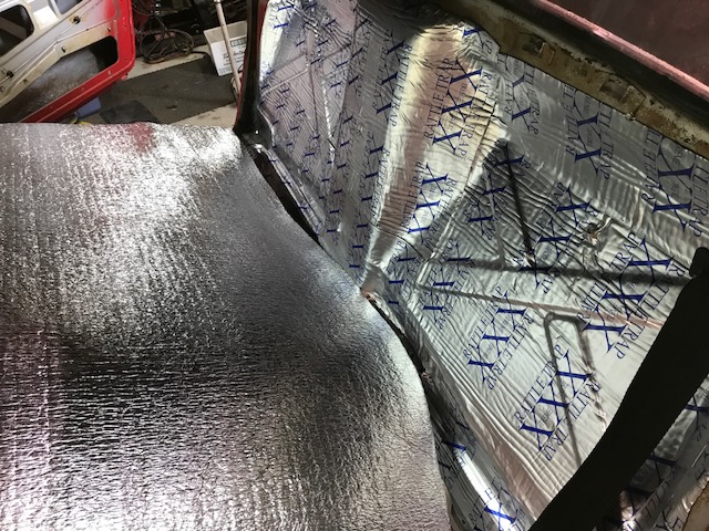

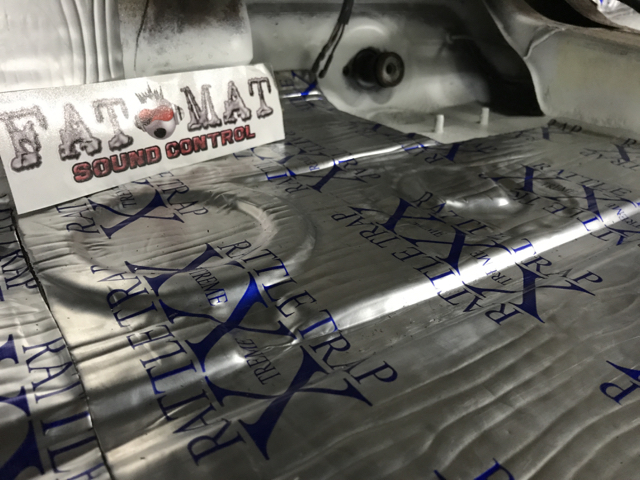

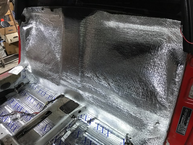

Jul 24 2018, 06:51 AM
I put a lot of miles on my teener, so I wanted the interior to be "relatively" quiet.
I went with Fat Mat on the interior side - slightly thicker than Dynamat and Xmat but same concept.
In the engine bay, I bought a 914Rubber replacement back pad years ago. Same thickness and fit as stock but won't hold water. Its holding up well and I am very happy with it.
I'd stay away from using the stock one. Even if you seal the edges, it will find a way to hold water.
