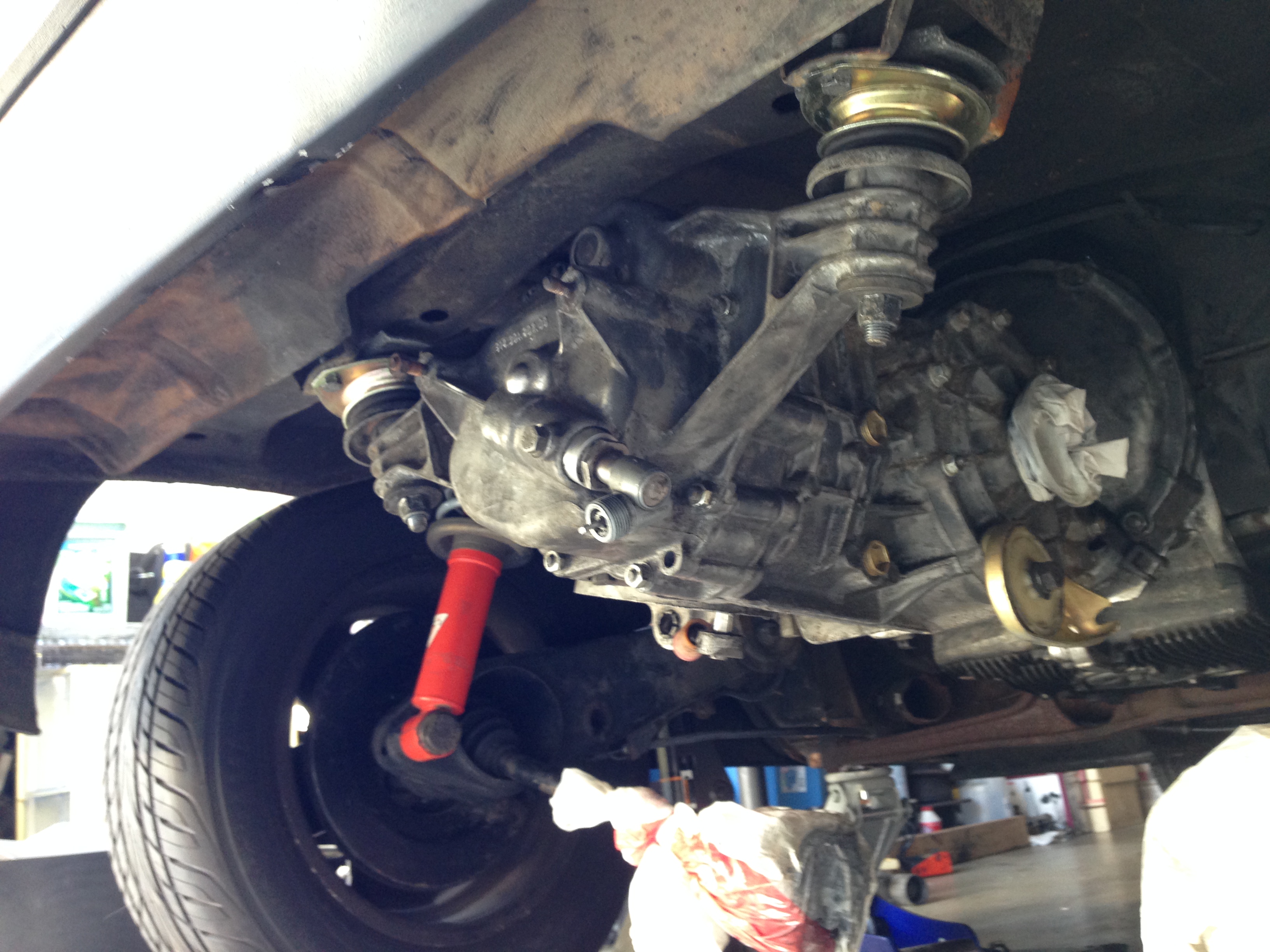

> Transmission mounting question, 911 mount- Question is do i use 911 washers too or just the 914 ones
DRPHIL914
post Jul 30 2018, 08:02 AM
Dr. Phil
Posts: 5,830
Joined: 9-December 09
From: Bluffton, SC
Member No.: 11,106
Here is what i have currently, and if the other washers were used the bolt would not be long enough.
this seems like it would be fine. i know for sure i wanted to use the cup washer on top of mount ear as it keeps it from being able to slide off even if it is loose.

Mblizzard
post Jul 30 2018, 02:25 PM
Posts: 3,033
Joined: 28-January 13
From: Knoxville Tn
Member No.: 15,438
This is how I have mine.
mb911
post Jul 30 2018, 02:31 PM
Posts: 7,609
Joined: 2-January 09
From: Burlington wi
Member No.: 9,892
My last 914 I did not use those washers with the 911 mounts.
DRPHIL914
post Jul 30 2018, 06:41 PM
Dr. Phil
Posts: 5,830
From: Bluffton, SC
Member No.: 11,106
i used the 911 washers with the 911 mounts but both the bottom ones were bent some, so it appears they are not as sturdy as these stock 914 washers, and they look nice too since being zinc coated by Mr. Stone, so i will leave this as is for now.
ndfrigi
post Jul 30 2018, 06:53 PM
Posts: 2,967
Joined: 21-August 11
From: Orange County
Member No.: 13,474
http://www.914world.com/bbs2/index.php?sho...p;#entry2535048
post Jul 30 2018, 06:58 PM
Resident German
Posts: 42,257
Joined: 21-January 03
From: Oakland, Kalifornia
Member No.: 179
QUOTE(Philip W. @ Jul 30 2018, 07:02 AM) *
That looks to be correct ...
