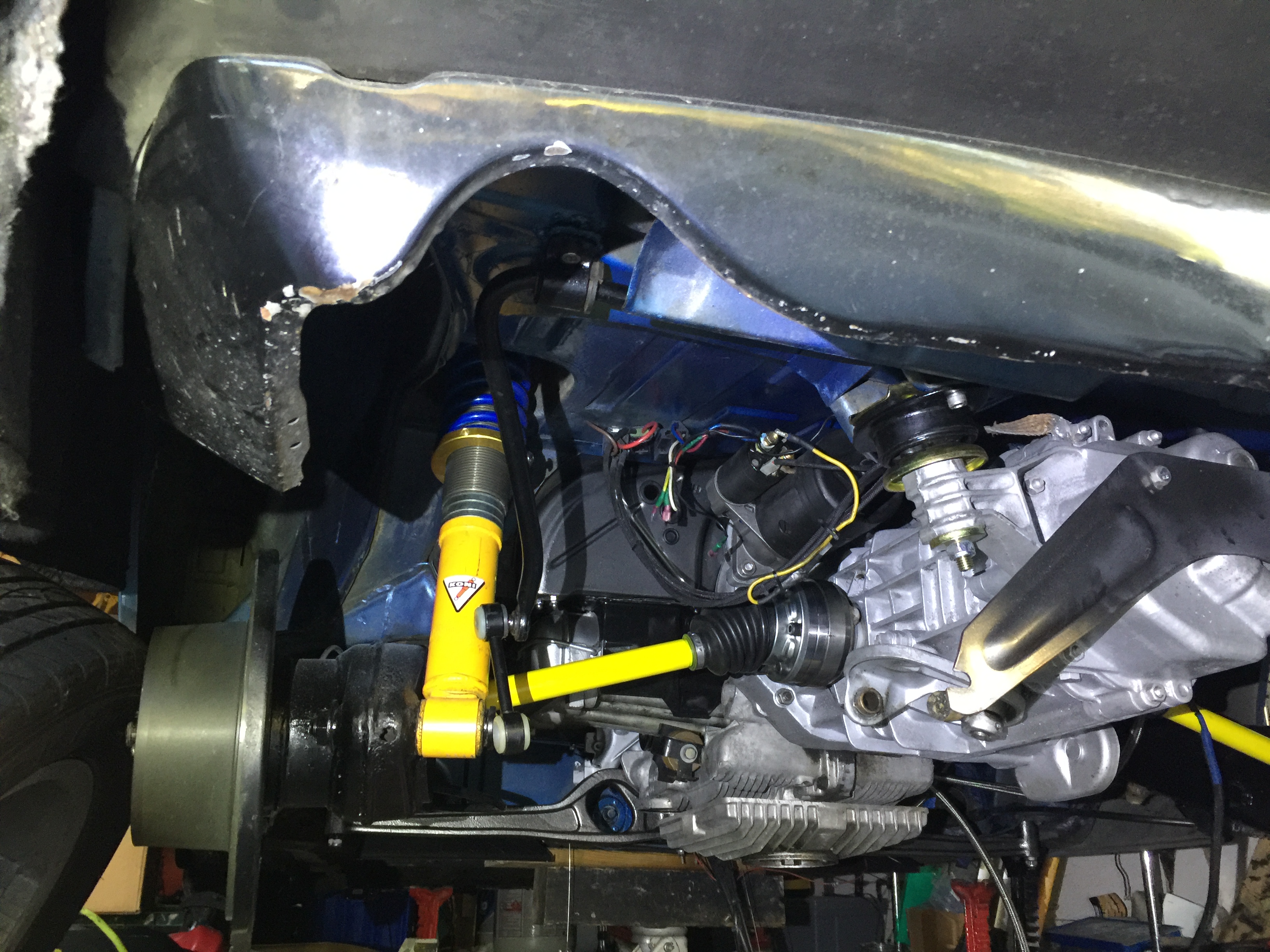

Here is what i have currently, and if the other washers were used the bolt would not be long enough.
this seems like it would be fine. i know for sure i wanted to use the cup washer on top of mount ear as it keeps it from being able to slide off even if it is loose.

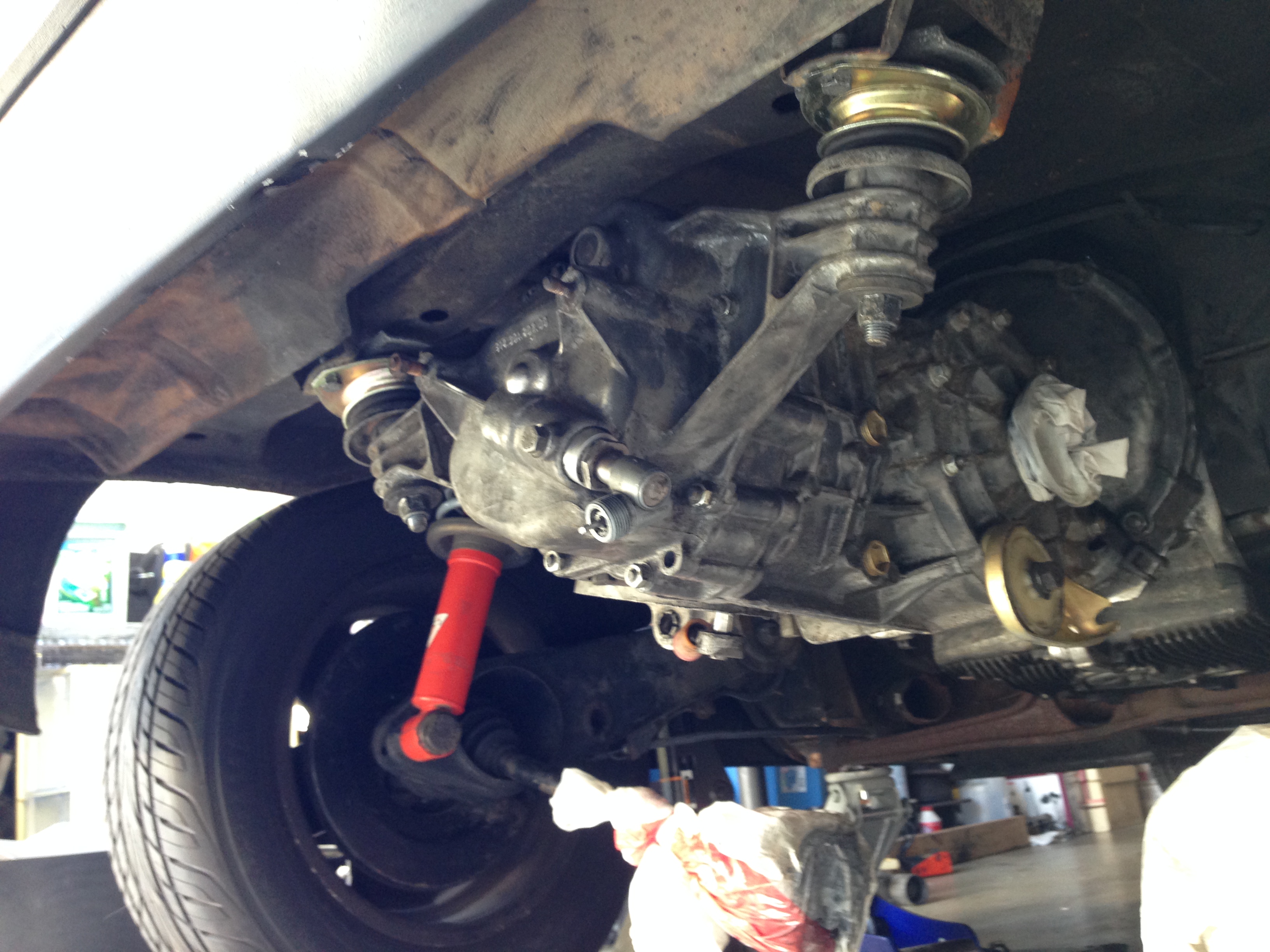

This is how I have mine.

My last 914 I did not use those washers with the 911 mounts.
DRPHIL914
i used the 911 washers with the 911 mounts but both the bottom ones were bent some, so it appears they are not as sturdy as these stock 914 washers, and they look nice too since being zinc coated by Mr. Stone, so i will leave this as is for now.
QUOTE(Philip W. @ Jul 30 2018, 07:02 AM) *
That looks to be correct ...
