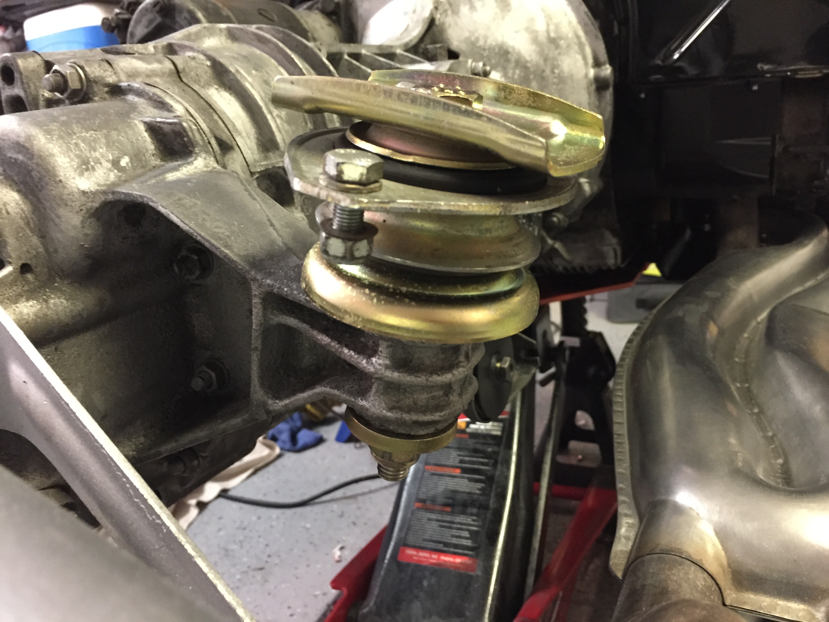

> Transmission mounting question, 911 mount- Question is do i use 911 washers too or just the 914 ones

Here is what i have currently, and if the other washers were used the bolt would not be long enough.
this seems like it would be fine. i know for sure i wanted to use the cup washer on top of mount ear as it keeps it from being able to slide off even if it is loose.
