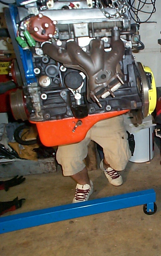

(IMG:http://www.914world.com/bbs2/html/emoticons/thisthreadisworthlesswithoutpics.gif)
for someone like me! I gotta see the installation, text blows my mind!
If you post a pic I'll know how you rotated it out of the way of the tin too! (IMG:http://www.914world.com/bbs2/html/emoticons/biggrin.gif)
Like this: here's a dizzy on a hachiroku w/legs
