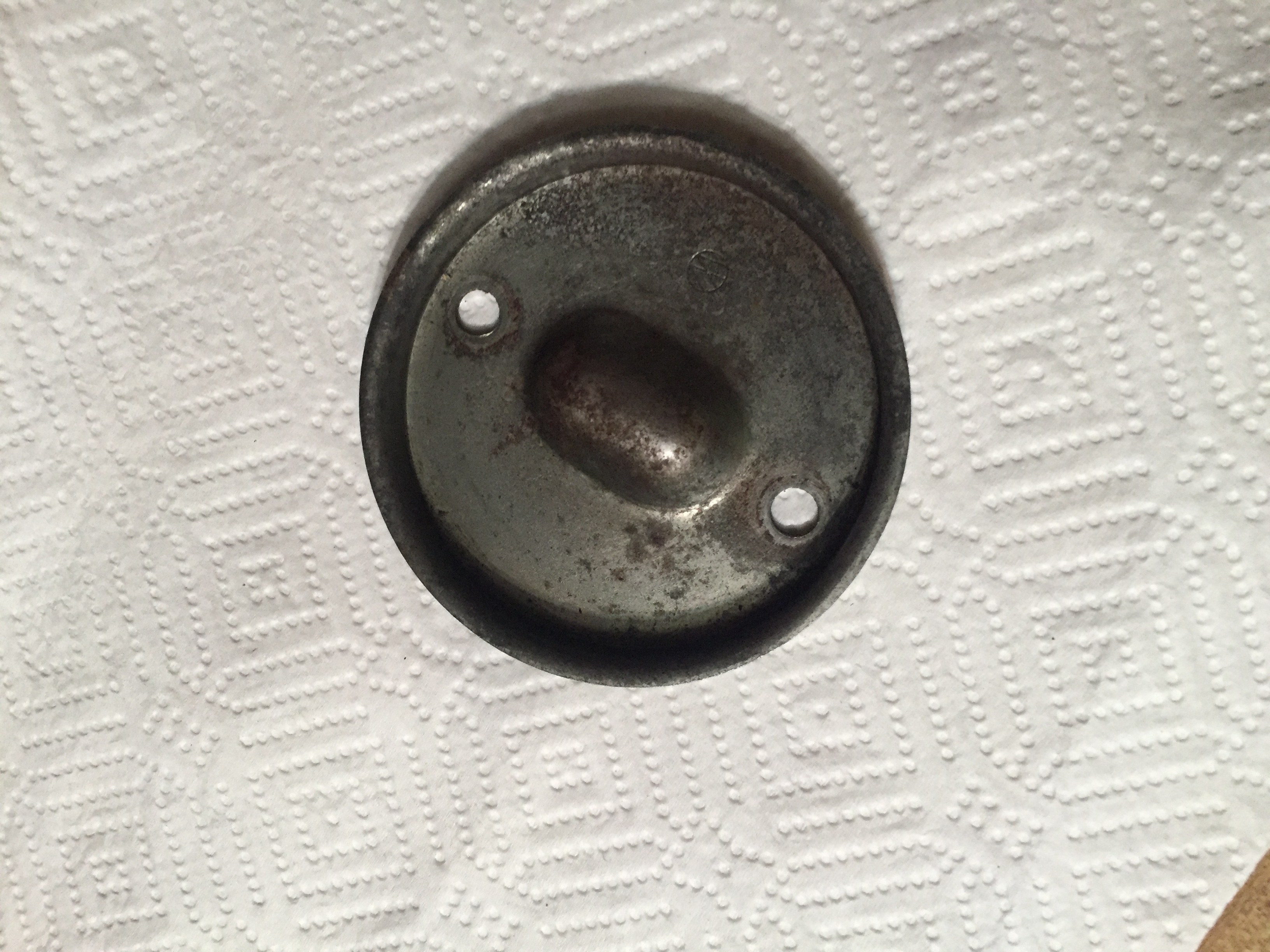

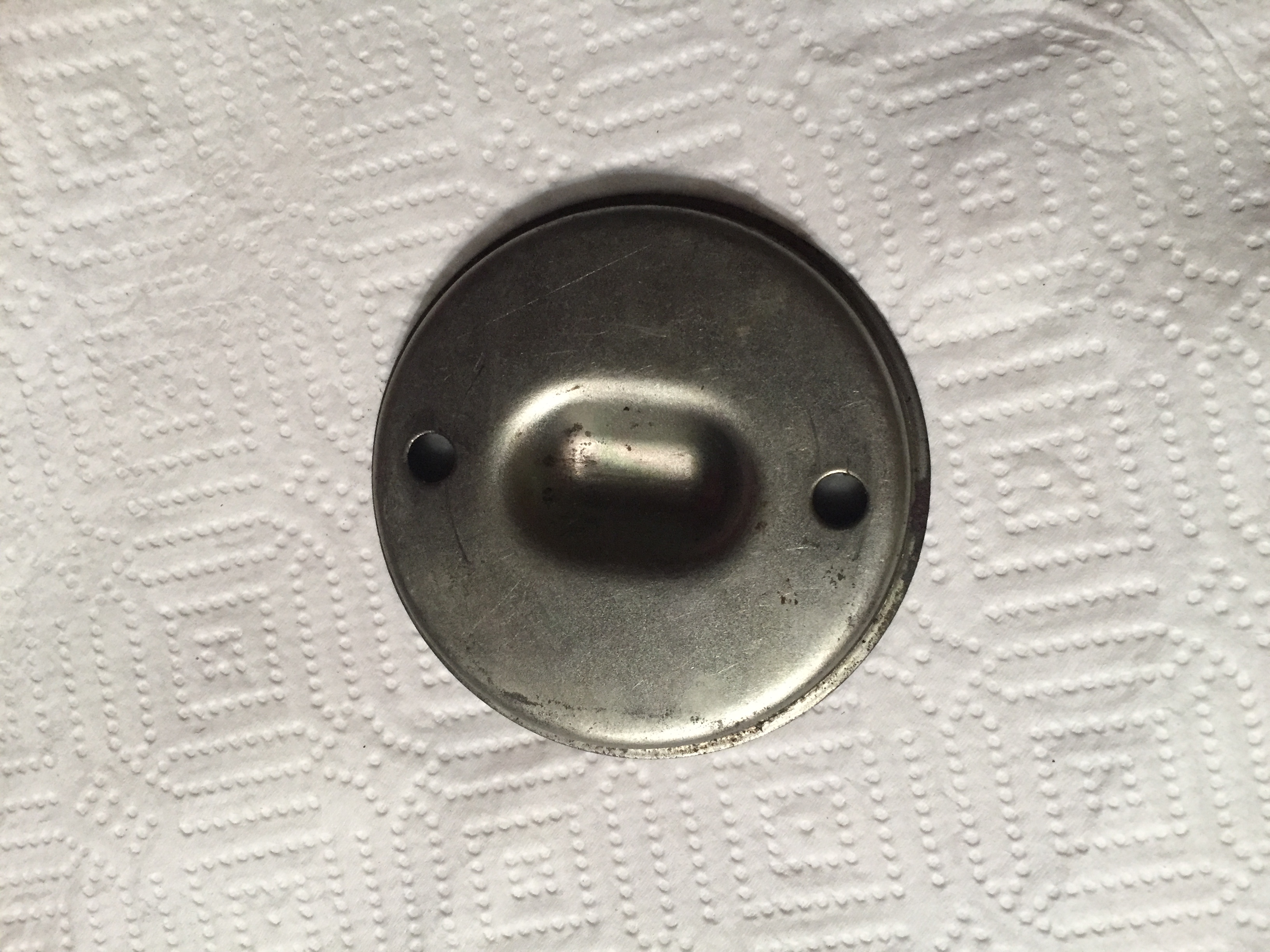

Yes. Do you need one? I post a picture.

"Standard" cars without the sending unit, as do VW 411's & Buses w/Type 4 engines (the 1970's Baywindows and early 1980's Vanagons), all use a taco plate without a hole for the oil temperature sending unit. They did not have oil temperature gauges from the factory.
As for the taco plate bolt washers, I use the copper ones from the engine gasket set, but they leak. I suppose you could try your local hardware store for a washer with a rubber sealing gasket bonded to it; I think they are called something like "stat-o-seal" washers.
