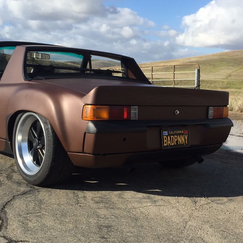

Damn that badpnny car is bad ass. I like everything about it! Well done.... (IMG:style_emoticons/default/smilie_pokal.gif) (IMG:style_emoticons/default/first.gif) ......Paul
