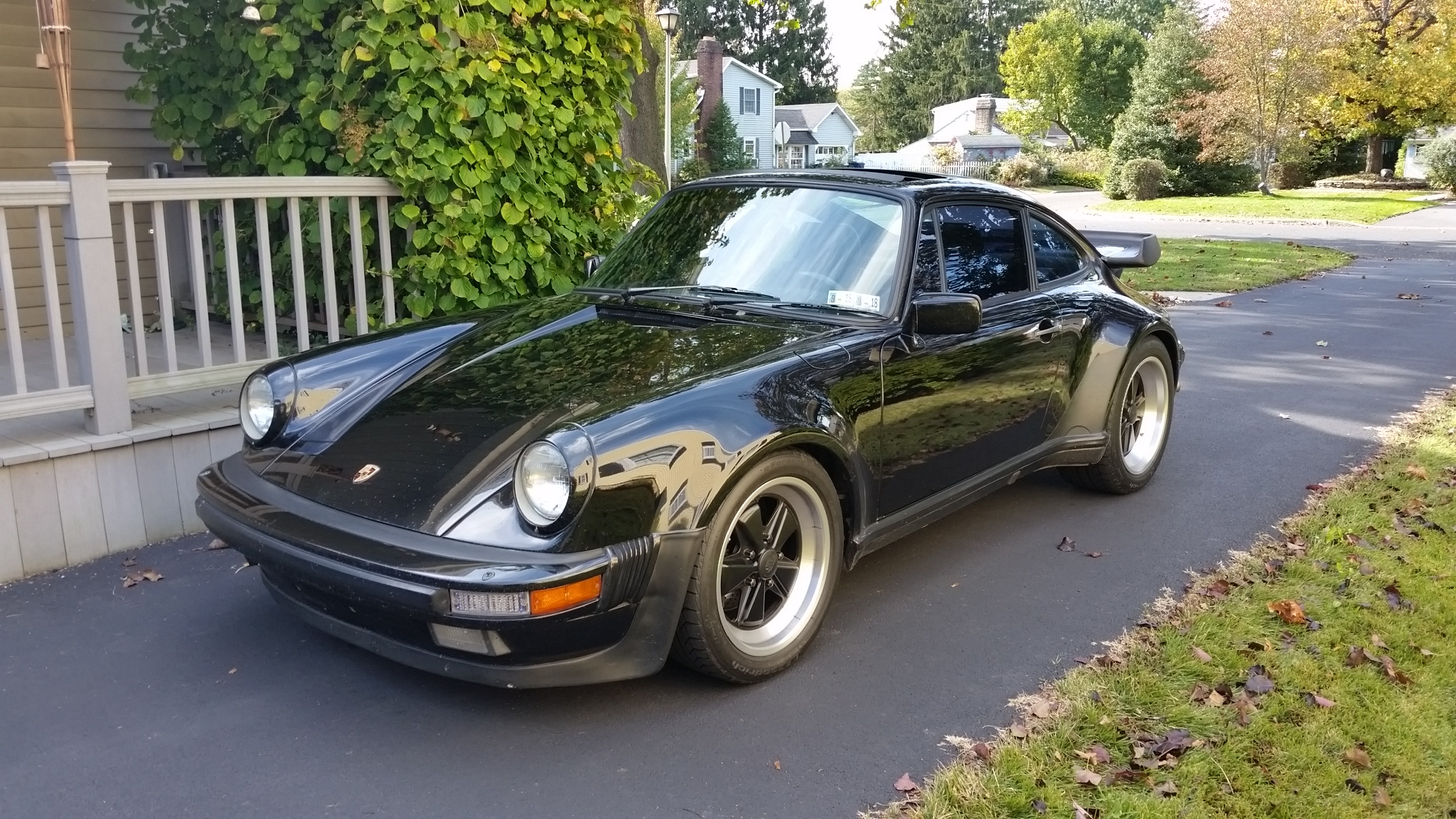

SO.O.C914er
Damn that badpnny car is bad ass. I like everything about it! Well done.... smilie_pokal.gif first.gif ......Paul
