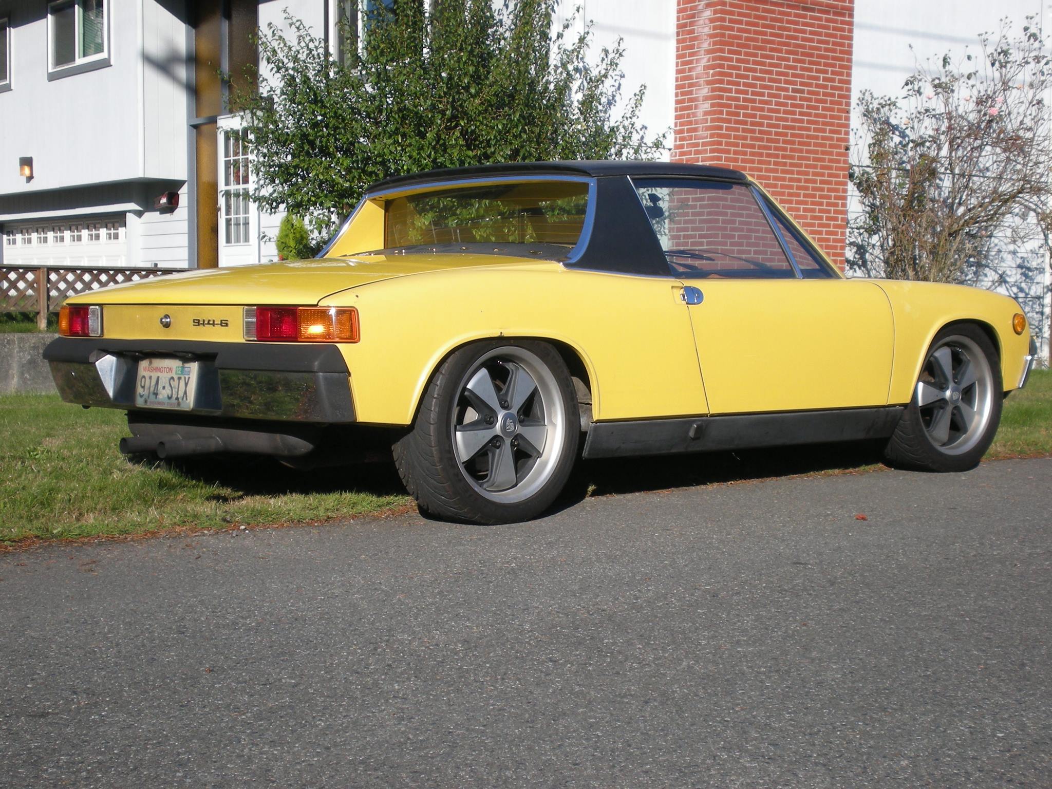

15x7 Fuchs are et23. Cookies are 15x7 et23. A 205 tire is pretty much 205 wide at the tread. So why doesn't the 17x7 et23 fit with a little rolling????
My 225/50 on 16x7 et40 +15mm spacer Boxsters fit great with DD's autox alignment. Then I bought an Eastwood tool and rolled the (IMG:style_emoticons/default/stromberg.gif) out of them that looks like they'll fit a 235-245.

Euromeister 7x17 on the front and 9x17 on the rear. Fit nicely and looks good.

Damn that badpnny car is bad ass. I like everything about it! Well done.... (IMG:style_emoticons/default/smilie_pokal.gif) (IMG:style_emoticons/default/first.gif) ......Paul
