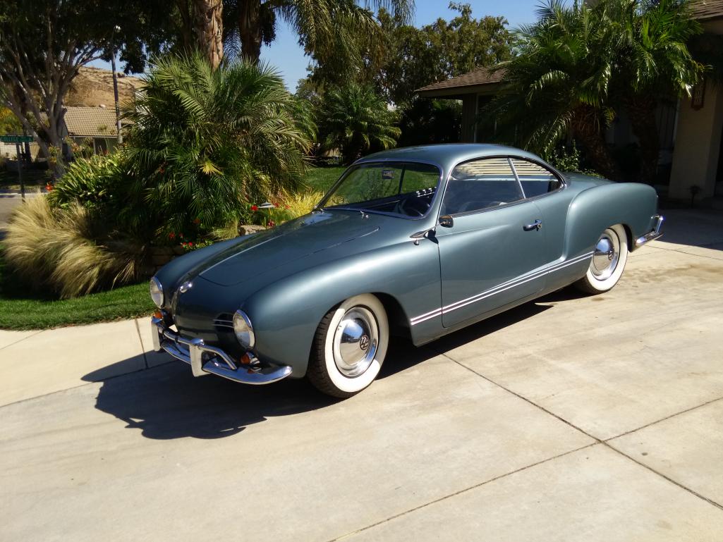

Go two stage as it is more forgiving
You can use just about any old gun for the color coat. I use a 50 dollar HF gun for that.
I use an Iwatta 400 for the clear.
Never run color through the gun you will clear with.
Below is my garage paint job
