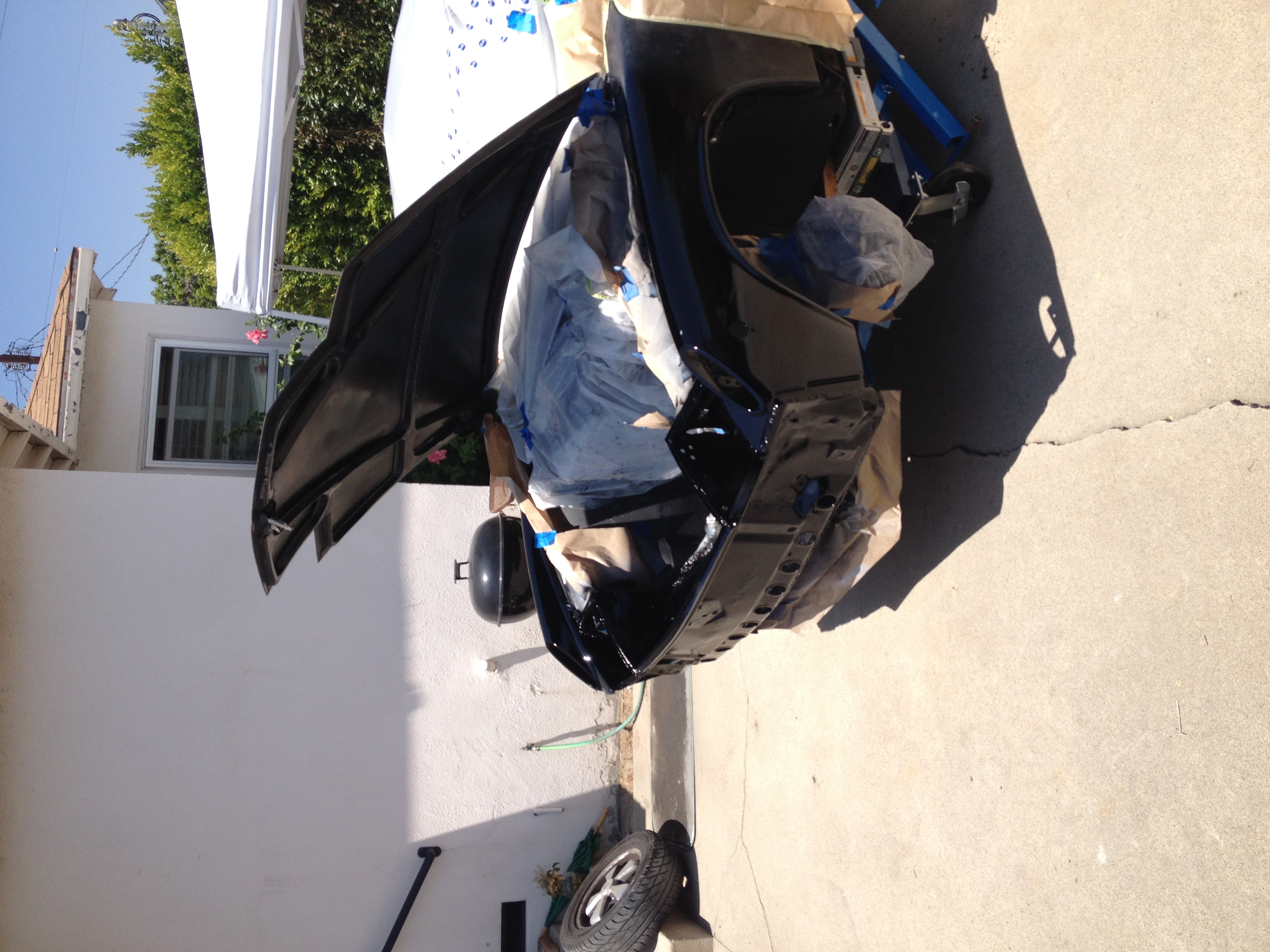

Below is my garage paint job

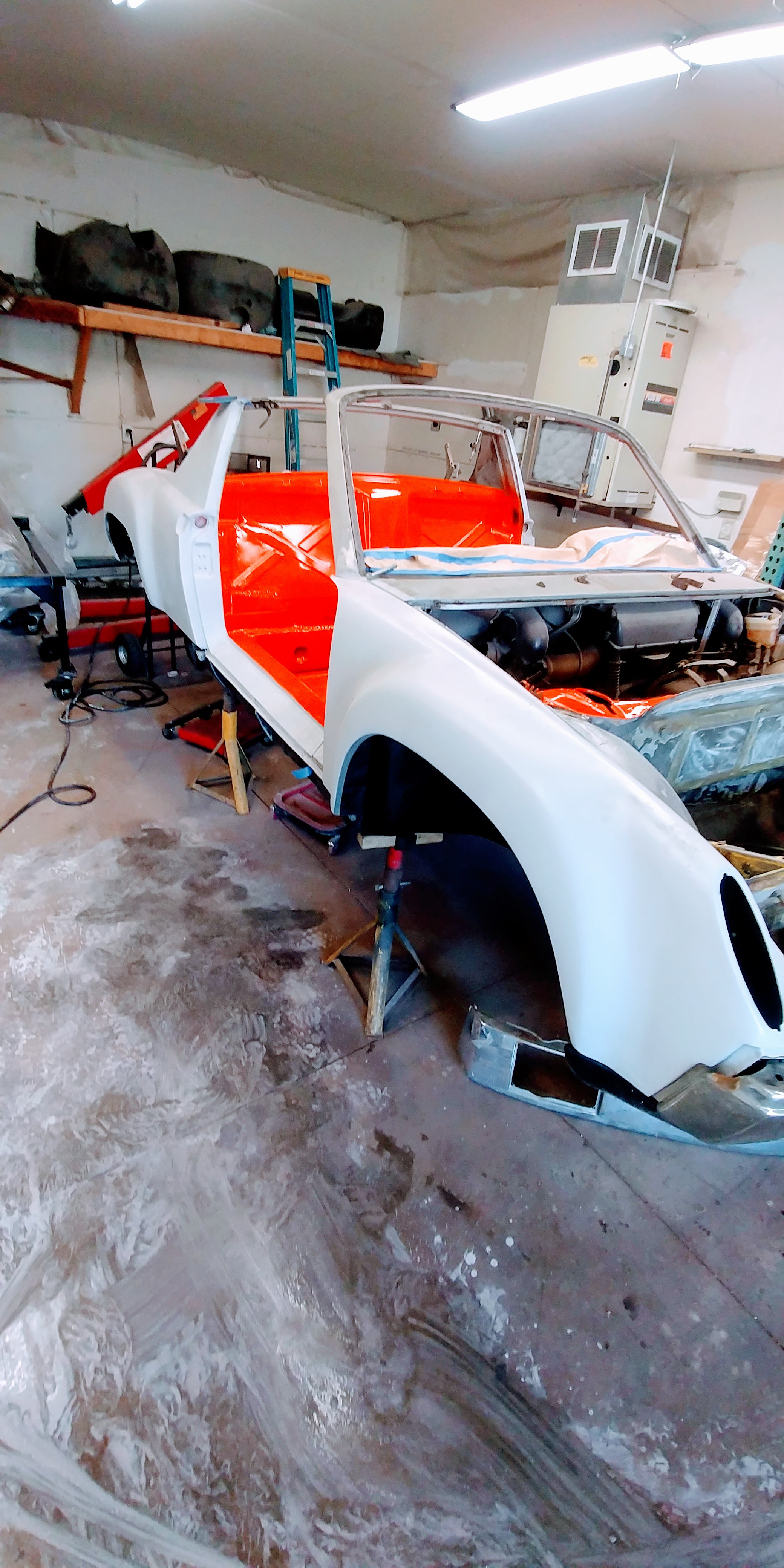

I bought the finishline kit and used both guns today to spray the cabin of my car and the hood of my sons 944. The guns both worked well. My Sata probably needs a rebuild.. I like the finishline kit for the costClick to view attachment
