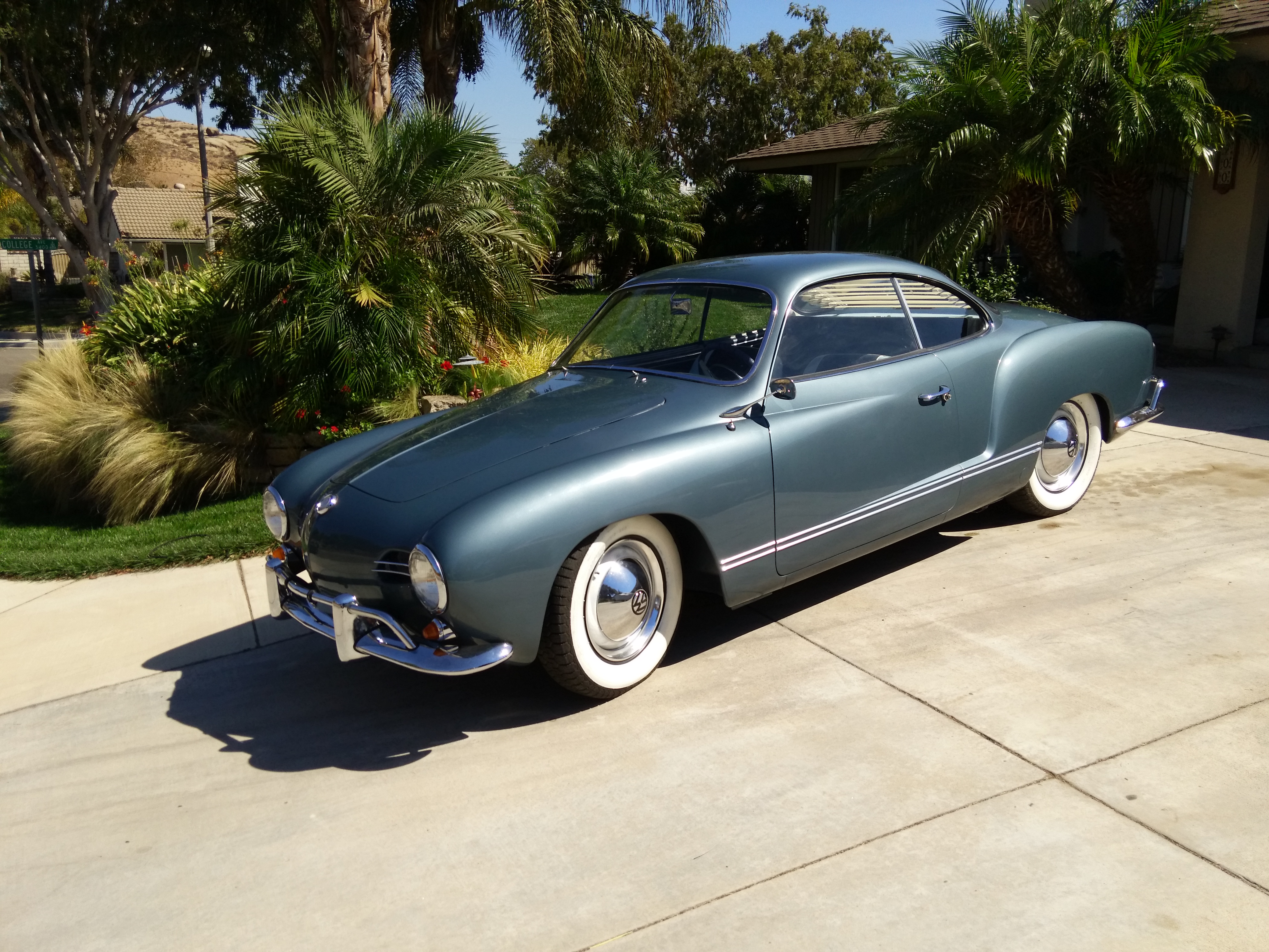

Go two stage as it is more forgiving
You can use just about any old gun for the color coat. I use a 50 dollar HF gun for that.
I use an Iwatta 400 for the clear.
Never run color through the gun you will clear with.
Below is my garage paint job

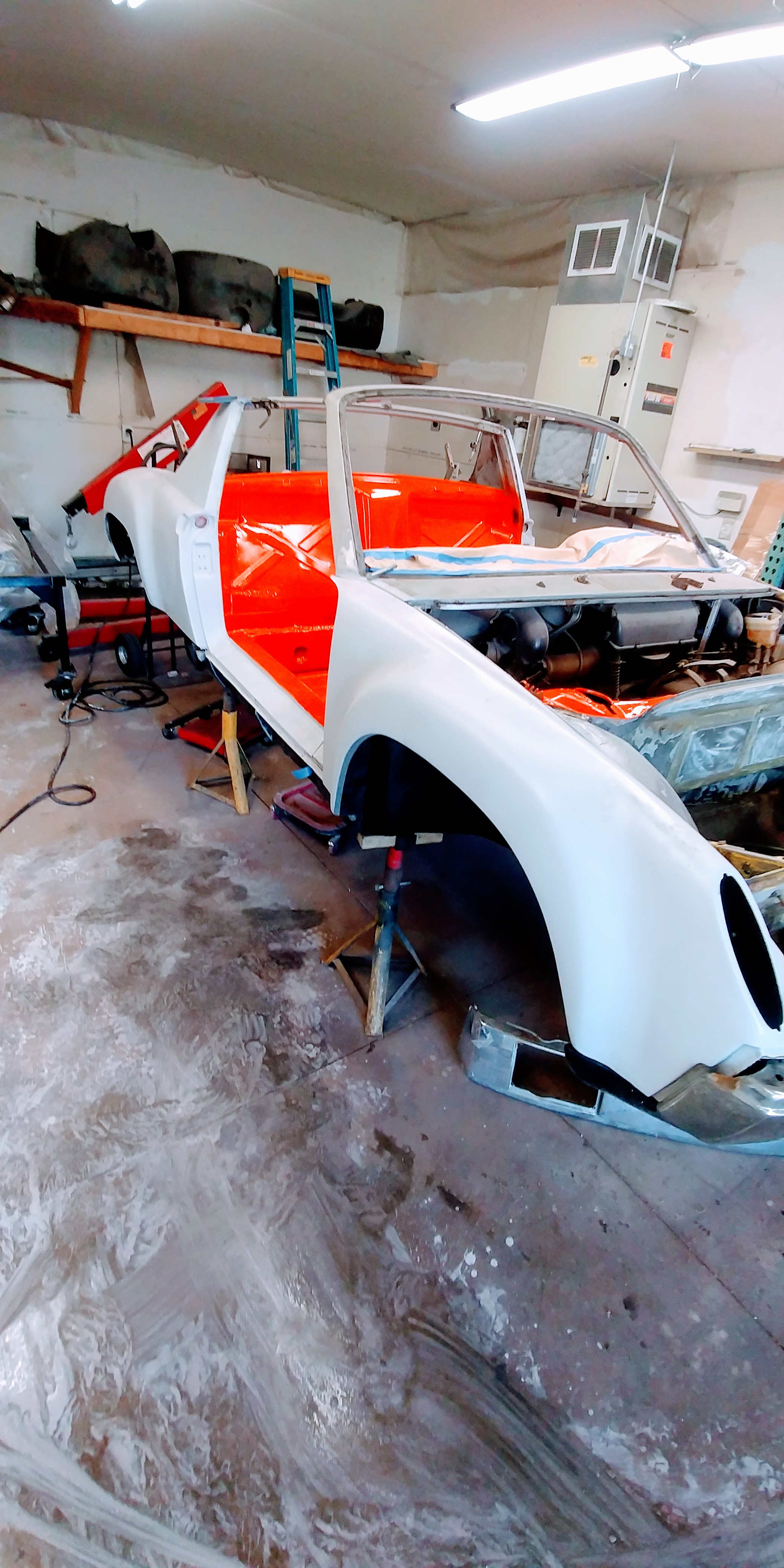

I bought the finishline kit and used both guns today to spray the cabin of my car and the hood of my sons 944. The guns both worked well. My Sata probably needs a rebuild.. I like the finishline kit for the costAttached Image
