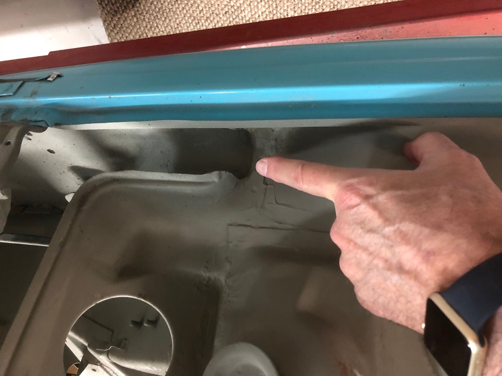

burton73
post Sep 25 2018, 02:17 PM
Senior member, and old dude
Posts: 3,979
Joined: 2-January 07
From: Los Angeles
Member No.: 7,414
I just happened to have one close by to take a picture of. When I bought my roller for my V8 from duc and Craig at Camp 914. my car had them in.
Bob B
