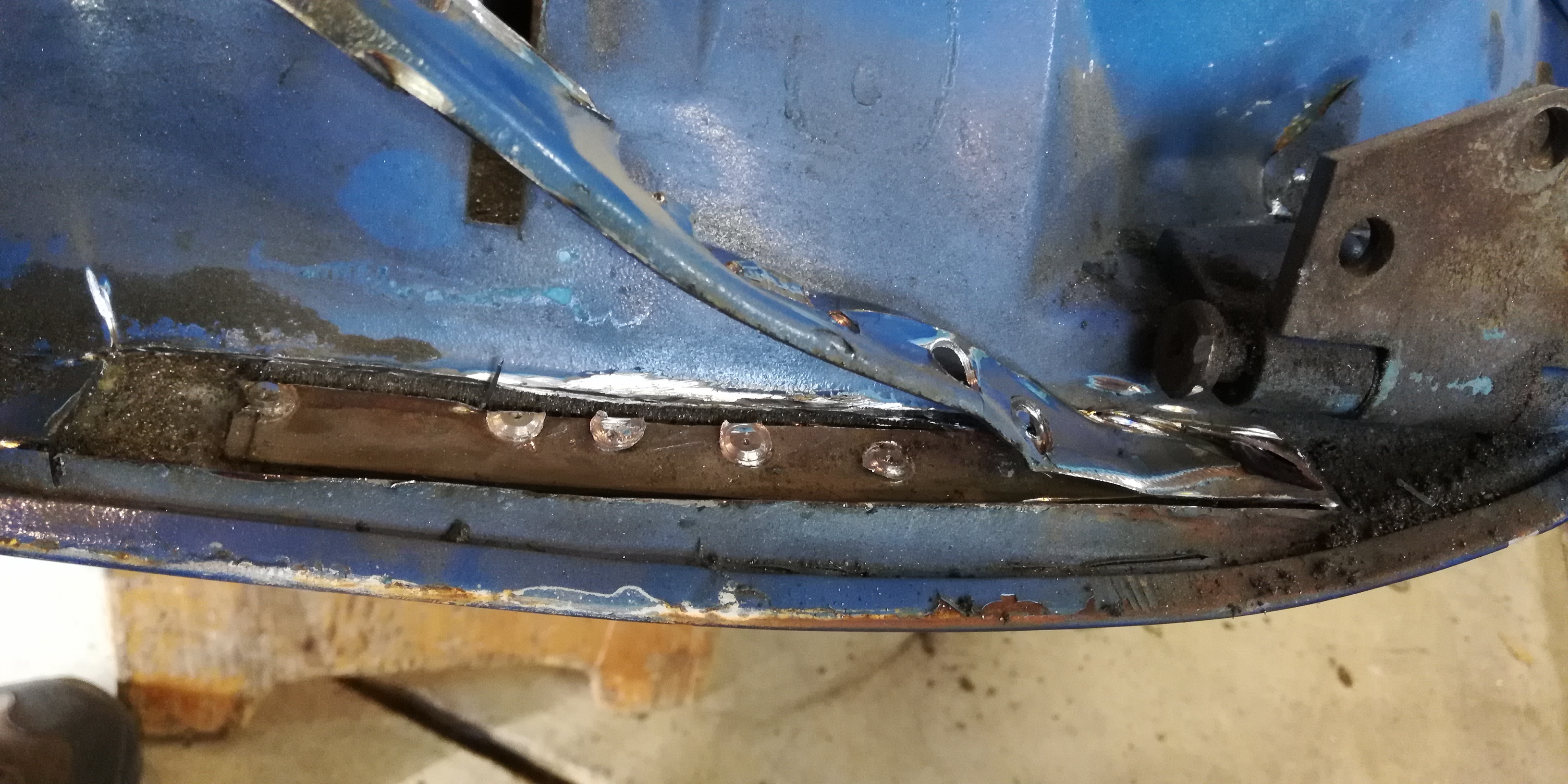

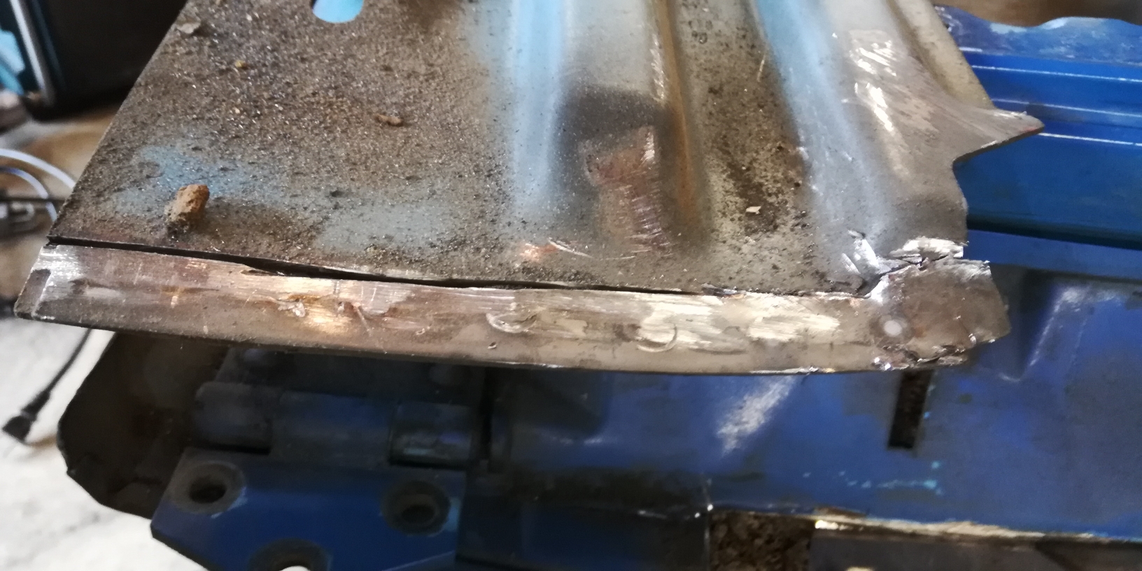

Here is how I got the front bar section out. It is riveted to the inside frame structure. I tried to drill out the rivets, but it wouldn't budge. So I cut that section out. After grinding it down I was able to wiggle it out from there. I'll put that section back in for strength.
Even so just that piece was 8#.
The back section was riveted to an bracket, but also looks to be riveted to the structure where the weatherstrip goes to seal the door to the body.
Weight changes
(bathroom scale measurements)
Full 1975 door weight 55# (no door card, or speakers etc)
remove window, internal components, and latch/handles 34#
remove 1/2 of the door bar 26#

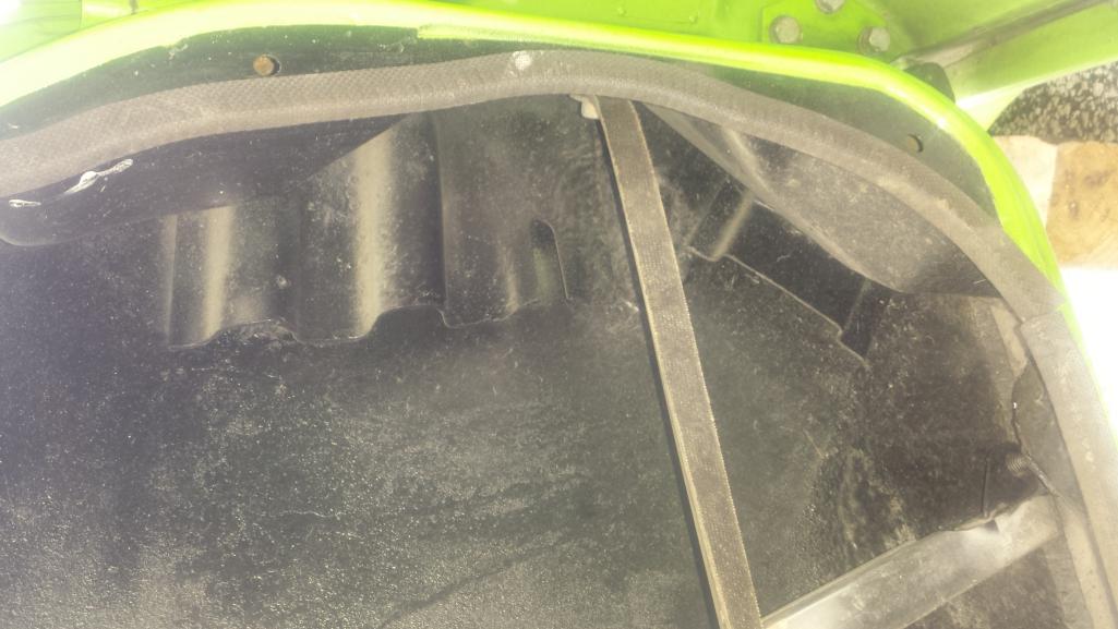

Just got back from Club NARP where my build thread is and it did not show how I got the bar out just that it weighed 11 pounds. looks almost exactly like yours. I think I used a small grinding wheel. the thread over there is in the garage under Carerror.

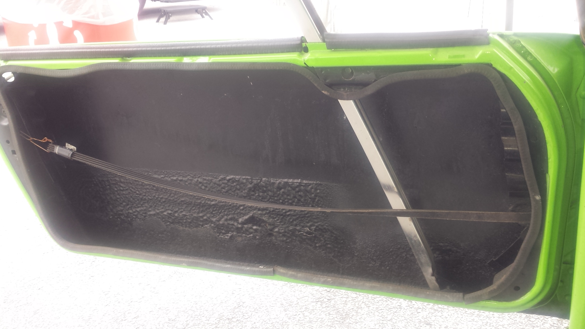

I used a three inch cuter wheel...pretty easy to get most of it, just left the stub..

Dan, I eventually cut the door skin off the door frame and welded them closed. I left the door handle in but the door gap is gone. I have had several people try to open the door.
