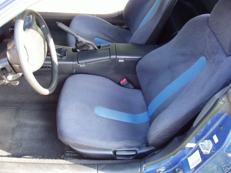

has anybody looked at the honda del sol seats
i had one parked right behind me last night, and i was looking at the seats, they have side bolsters that are a nice size for a touring seat. they also look like they are low enough to fit well, with out being too wide.
the seats look comfy (IMG:http://www.914world.com/bbs2/html/emoticons/wub.gif)

here is a pic from an ebay car
and here is a seat of monza seats on ebay for
cheap

another clearer pic from another car

sanglee007
post Jun 19 2005, 11:28 AM
Unregistered
QUOTE (scott thacher @ Jun 18 2005, 10:27 PM)
i can probably get delsol seats for 50 to 100 a piece
Nope.
Del Sol seats range from 150-300+
They are coveted in the Honda world as they bolt into almost any honda after 1992 and lower your seating position while providing better support than crappy civic seats.
Like almost every honda seat after 1992, they are side mounted on some funky brackets. To put them into the 914 you'll end up cutting the bottom half of the brackets off and then welding the 914 rails to a crossover piece. It'll bring you up 2+ inches, and won't sit right in the 914. 914 seats are way way low, and while del sol seats are low for a honda, they're not 914 low.
Sang 92/Civic Hatchback + Del Sol seats
