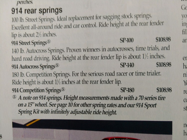

Weltmeister, who used to be part of Automotion, that was sold to Performance Products, that I think was sold to someone else?
Anyway, they should be 100 lb/in, and shorter than stock. Stock springs were on the order of 50-65 lb/in, depending on which version. You can work out the rates from some of the info in the factory manuals, though it takes some math and you have to work out what exactly they are specifying in each section of the manual.
