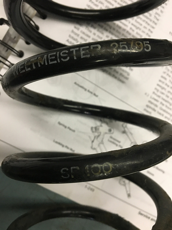

I installed these springs in my V8 914 last week...
IPB Image
I believe them to be 100# springs and they did put the ride height exactly where I wanted it (the car was a little low for me with the stock springs).

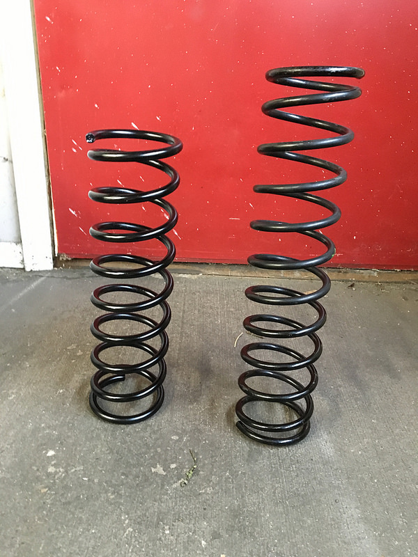

I was surprised, however, that they were shorter than the stock springs...
IPB Image
I had always thought that 100# springs were the same height as stock springs, just with thicker wire.

those are performance products 100 lb springs, for your v8 I would install 180 progressive springs
dr914@autoatlanta.com
we had made exact replicas of the original 914 springs, and 914-6 springs. Both are the same length , the 914-6 springs have thicker coils.
Very important to match spring rates to keep the stock factory tuned performance. They knew what they were doing so who are we to improve upon that.
However in modified situations, like yours, or for racing, different springs are required.
These days everyone with a stock car wants to keep it stock so returning the car to the factory configuration. If you have a stock car, do not waste your money on anything BUT the factory rate springs.

Weltmeister, who used to be part of Automotion, that was sold to Performance Products, that I think was sold to someone else?
Anyway, they should be 100 lb/in, and shorter than stock. Stock springs were on the order of 50-65 lb/in, depending on which version. You can work out the rates from some of the info in the factory manuals, though it takes some math and you have to work out what exactly they are specifying in each section of the manual.
