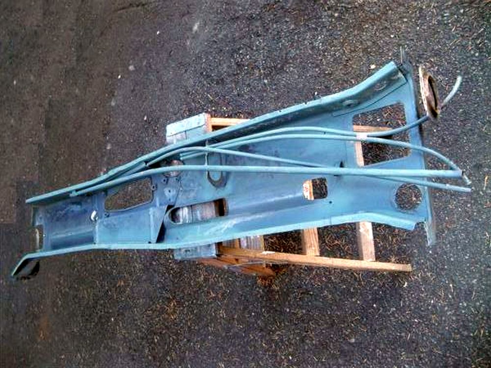

JeffBowlsby
post Dec 1 2018, 12:23 PM
Posts: 9,024
Joined: 7-January 03
From: San Ramon CA
Member No.: 104
76-914
post Dec 1 2018, 06:24 PM
Posts: 13,786
Joined: 23-January 09
From: Temecula, CA
Member No.: 9,964
Great pic Jeff. I just got it back together. I was wrong on two accounts. #1) What I thought to be the front weld breaking loose was actually the clip that holds the clevis to the clutch pedal cam. It rotated and was contacting the speedo cable. #2) The front and rear weld joints had been repaired previously but the middle one broke loose allowing the tube to flex quite a bit from right to left when the pedal was depressed. I read somewhere that the early model had a different center brace. Not much meat there so it was bound to wear out after 49 years. (IMG:style_emoticons/default/lol-2.gif) Now I've got a solenoid going south. (IMG:style_emoticons/default/headbang.gif) It's always something. (IMG:style_emoticons/default/beerchug.gif)
