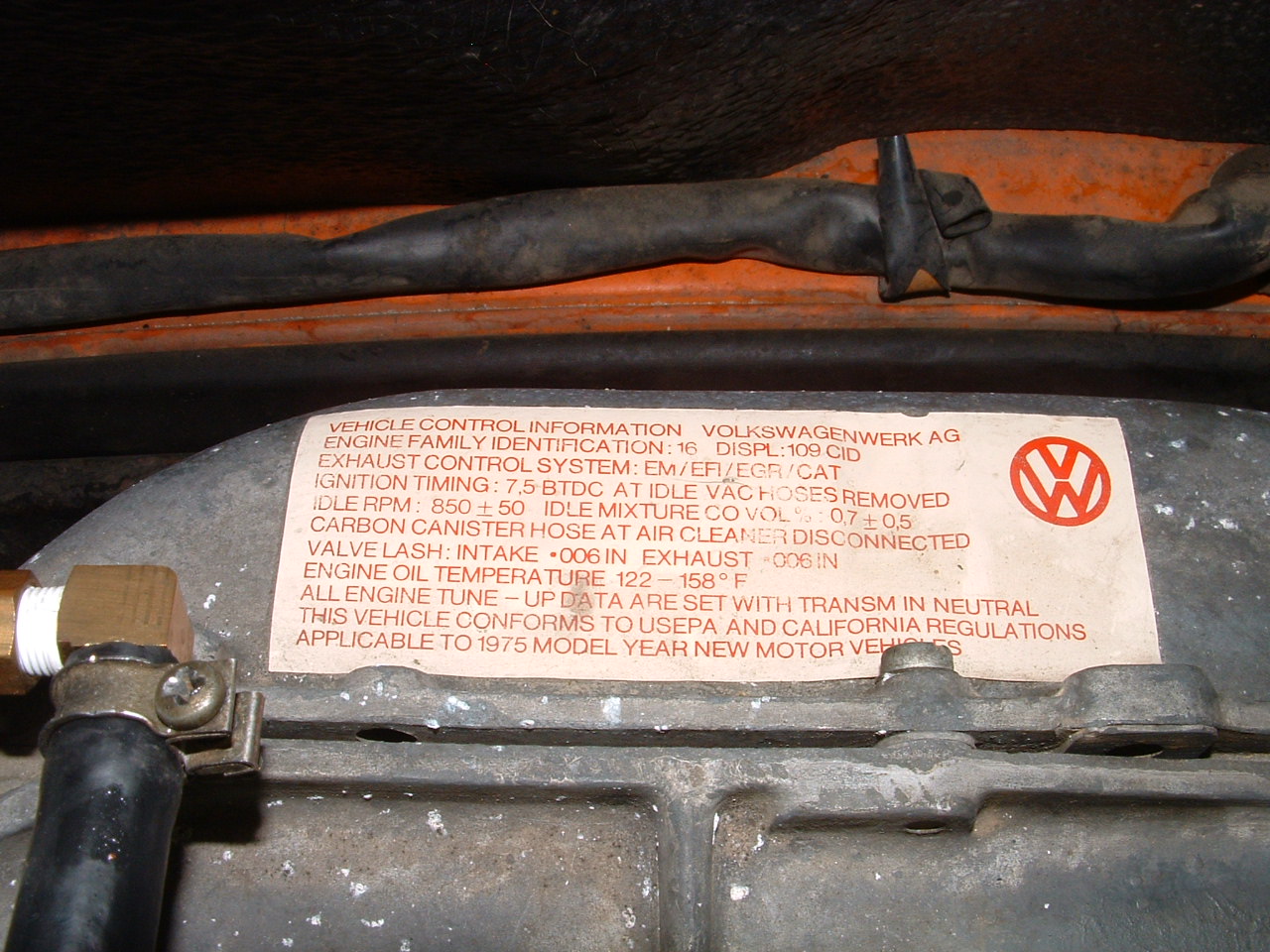

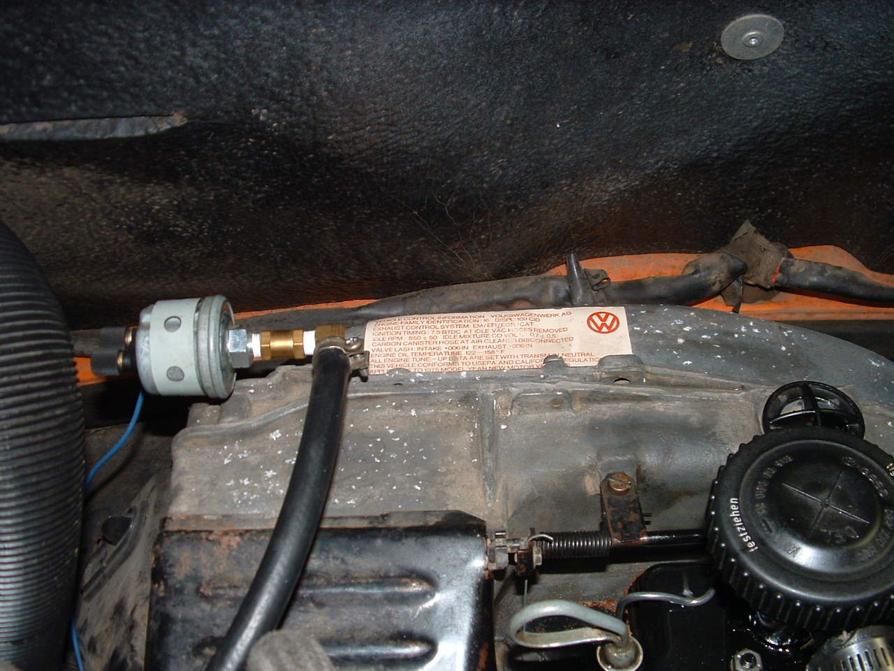

DickSteinkamp
post Dec 1 2018, 01:42 PM
Posts: 500
Joined: 27-February 17
From: Bellingham, WA
Member No.: 20,876
I have these emissions stickers on my 1976 MY (at least it is registered as a 76), September 1975 production California delivered 914. Original paint.
(IMG:http://www.914world.com/bbs2/uploads_offsite/farm5.staticflickr.com-20876-1543693376.1.jpg)
(IMG:http://www.914world.com/bbs2/uploads_offsite/farm5.staticflickr.com-20876-1543693376.2.jpg)
(IMG:http://www.914world.com/bbs2/uploads_offsite/farm5.staticflickr.com-20876-1543693377.3.jpg)
(IMG:http://www.914world.com/bbs2/uploads_offsite/farm5.staticflickr.com-20876-1543693377.4.jpg)
