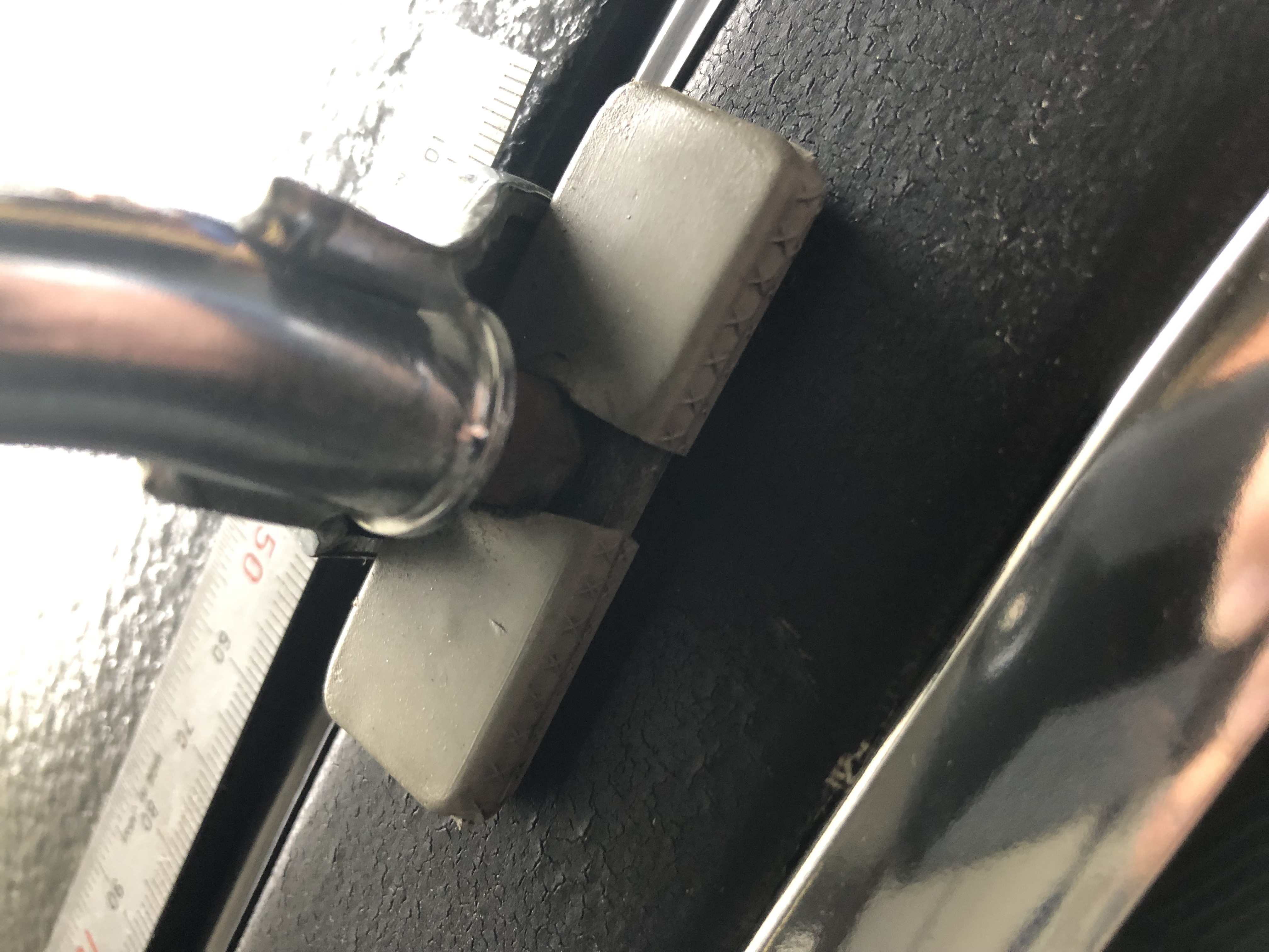

(IMG:http://i1084.photobucket.com/albums/j417/chuckgf8/IMG_20181205_120455_zpskllav9ep.jpg)
Are these the front mounts?

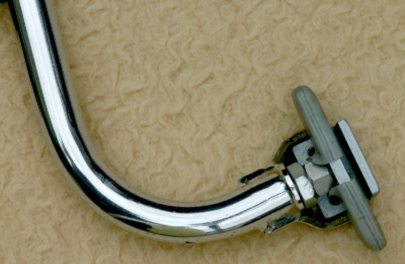

You are missing the screw-down feet that actually firm up the clamping action of the front rack. Those "L" brackets pictured above are what goes into the A pillar slots, but the steel/rubber coated/sleeved feet are what you need.
The picture Bowlsby posted has a pretty good shot of what you are after.

Yes, my rack has the L-brackets like posted by @Chi-town .
Detail on @JeffBowlsby picture is great, but to recreate this part I would need different angle photos and dimensions.
@Larmo63 : Thanks, I'll be very happy if you can take some pictures.

The feet are approximately 50mm long x 15mm wide.
Nothing fancy.
You really just need two pieces of flat stock, slightly rounded on the ends, fitted to the screw down parts.
You could then Plasti-Dip them in grey?
