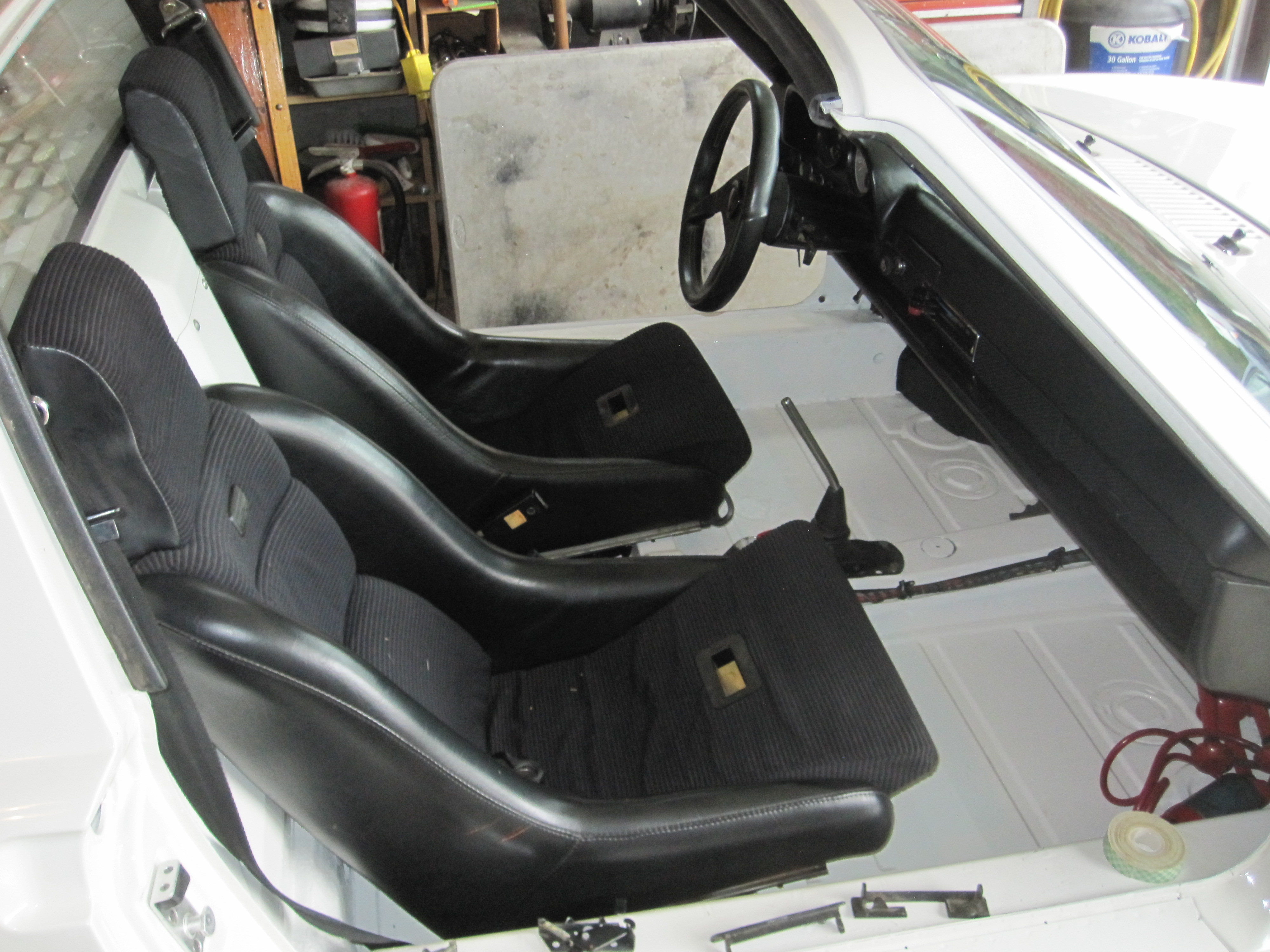

I have a set of Scheel seat that I’m contemplating on installing. I’m wondering as I’ve heard the rails are very hard to find. I need to get the seats out storage but thought I’d check here first as to if it’s possible to use the 914 rail or would I need to adopt? Thanks!

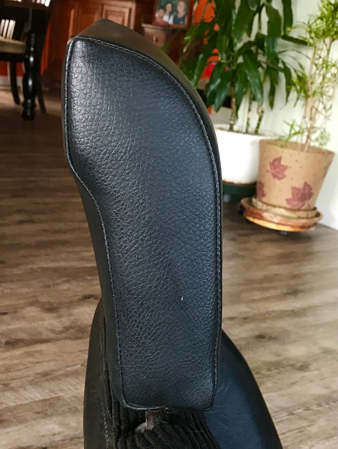

WOW Mike they’ve been around! How did they fit in your car and why’d you pull them out? If it’s true the 300 series had no headrest mine aren’t 300 series as they have headrest. The headrests appear to be shaped on the back for the backpad/window shape. Just brought them home but no time right now play with the fit but anxious too be installing them. Attached Image

The headrest!Attached Image

Did a dry fitting and all is good perfect fit on rails and the back slant ideal to the backpad. Thanks all!
