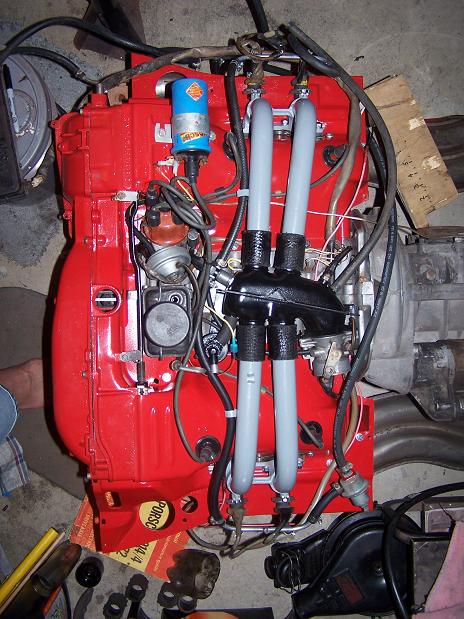

Hi - I'm just eventually starting to fit the d-jetronic FI which Clay kindly sent me onto my 1.7 '73 car. I've stripped off the single webber and am just taking it slowly, and buying bits as I need them. I am currently swapping out the distributor to the FI one with the trigger points, and I just wondered if it mattered which way round the body goes please? It only seems to fit in a few positions due to the vacuum canister on the side, and obviously I will need to rotate it to set the timing, but do the trigger points fire all the cylinders each quarter turn please? I seem to remember from a V8 mercedes I had once that the injectors fired in pairs.
Thanks, Dylan

The trigger points fire 2 injectors at a time.
Yes, the distributor only fits one way. Here's a picture of my engine showing the distributor mounting.

Thanks - that's a great photo to help me get everything in the right place. Brilliant.
