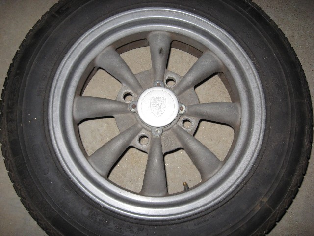

I had the 1997 (or 1987? per DOT date code) tires pulled off of these rims so I can clean them up and repaint them. I have not found any markings on them indicating the brand. If I measured correctly they are 15 x 5.5. They had Avon 195/60 15 tires mounted on them.
Any one know what they may be? I believe true mini liters would have the name embossed on them. Any suggestions for cleaning up the old paint overspray on the inside back?
Sorry for the poor quality picture. Taken at dusk.
Randy
PhoenixAttached Image Attached Image

Look like Empi type to me.
post Mar 10 2019, 08:45 PM
914-6 GT in waiting
Posts: 20,534
Joined: 19-September 09
Member No.: 10,825
probably empi or similar. Not even close to minilites.

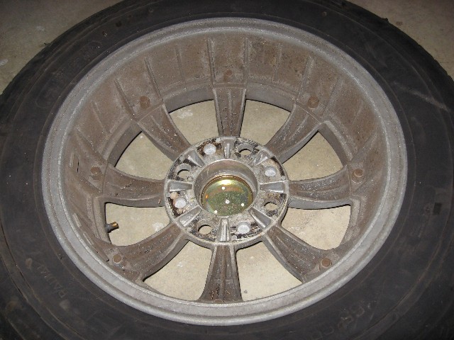

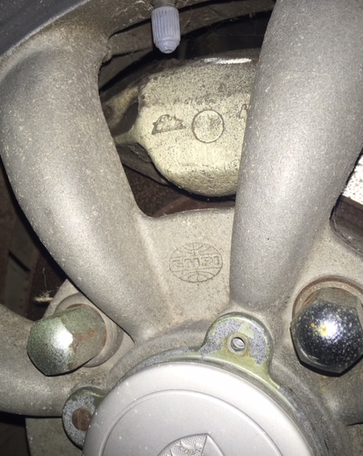

Identifying EMPI 8 spoke wheels:
Genuine, original EMPIs are two piece wheels that seal with a large o-ring between the halves or, more likely, run tubes.
The EMPI logo is cast into the spoke web, directly opposite the valve stem.
The wheels are mounted on screw in threaded studs. There are steel hex closed lug nuts torqued down on steel centering bushings that slip over the studs.
The original center caps had 4 tabs for attachment.

Thanks. So not empis and not minilites

Always thought mine were Empi's. My center caps do not have the 4 screw tabs but just pop in. Does that help identify them?
jmitro
post Mar 11 2019, 12:11 PM
Posts: 713
Joined: 23-July 15
From: Oklahoma
Member No.: 18,986
empi repros.
I had those on my 73 VW bug 25 years ago (IMG:style_emoticons/default/biggrin.gif)

empi reproductions
heavy
cheap
probably have the wrong offset
and still sold new affordable

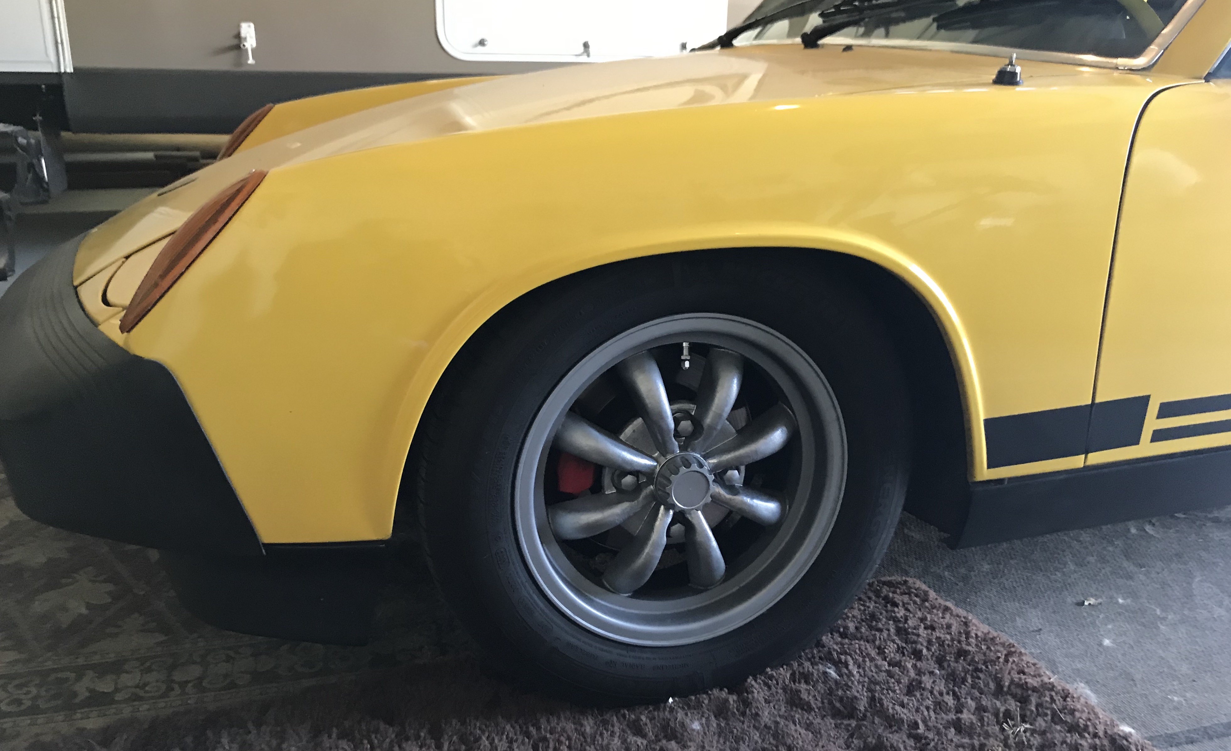

I need to buy tires for theses wheels. I have never had my 914 on the road, and these wheels (15"x5.5") have not been used on this car except as a motor less roller. I took off 205/60/15 tires, but after reviewing posts here and on PP it seems to me that 205/65/15 would be a more logical choice.
Your thoughts?
