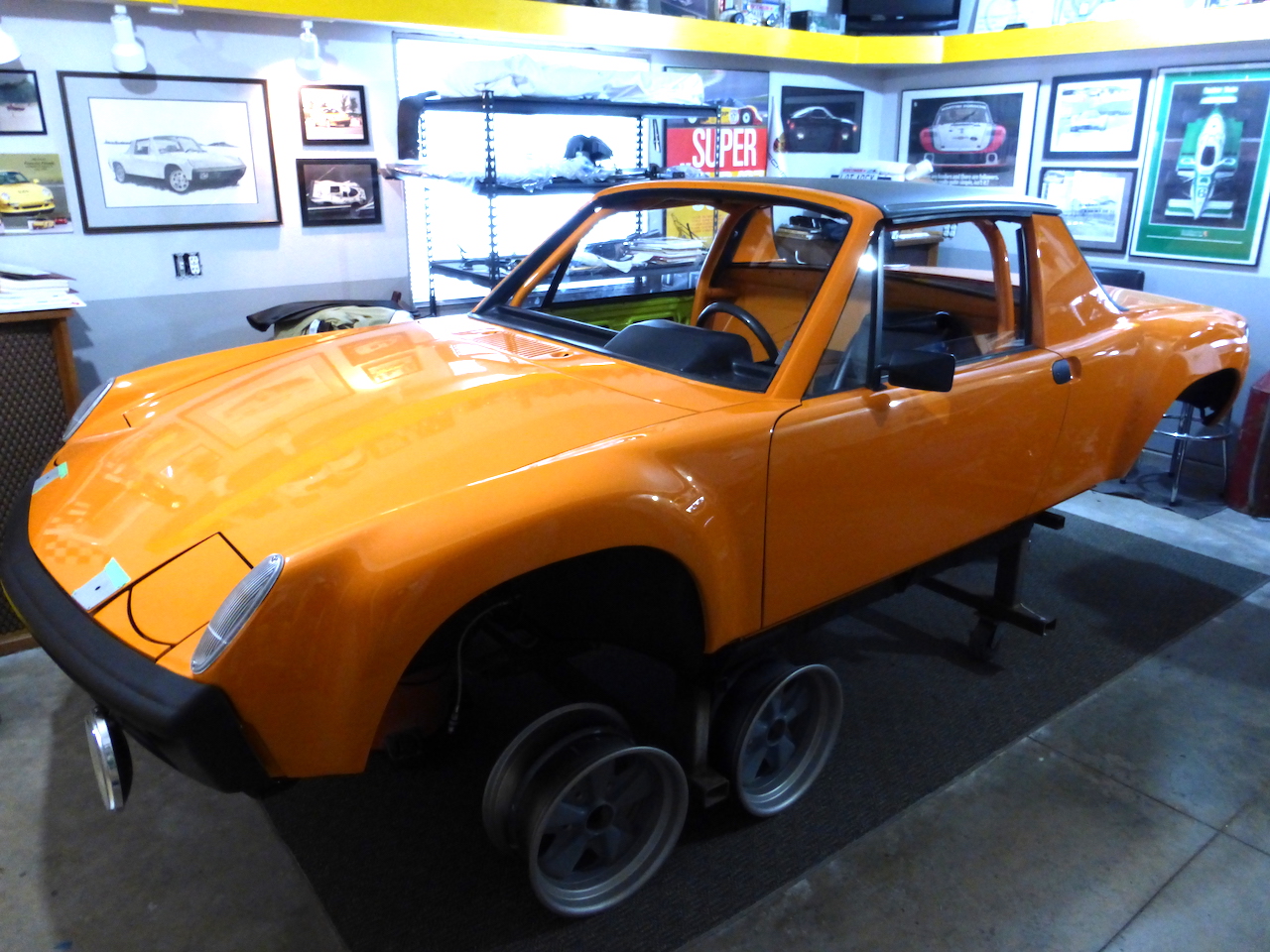

Mark, mine is in the last stage of assembly. Two years ago after having it painted I had it insured for $35,000 agreed value. Same reason, fire, theft.....Not sure what final value we be. Best, MarkAttached Image

I bet a car like this would cost $75k+ to replace.

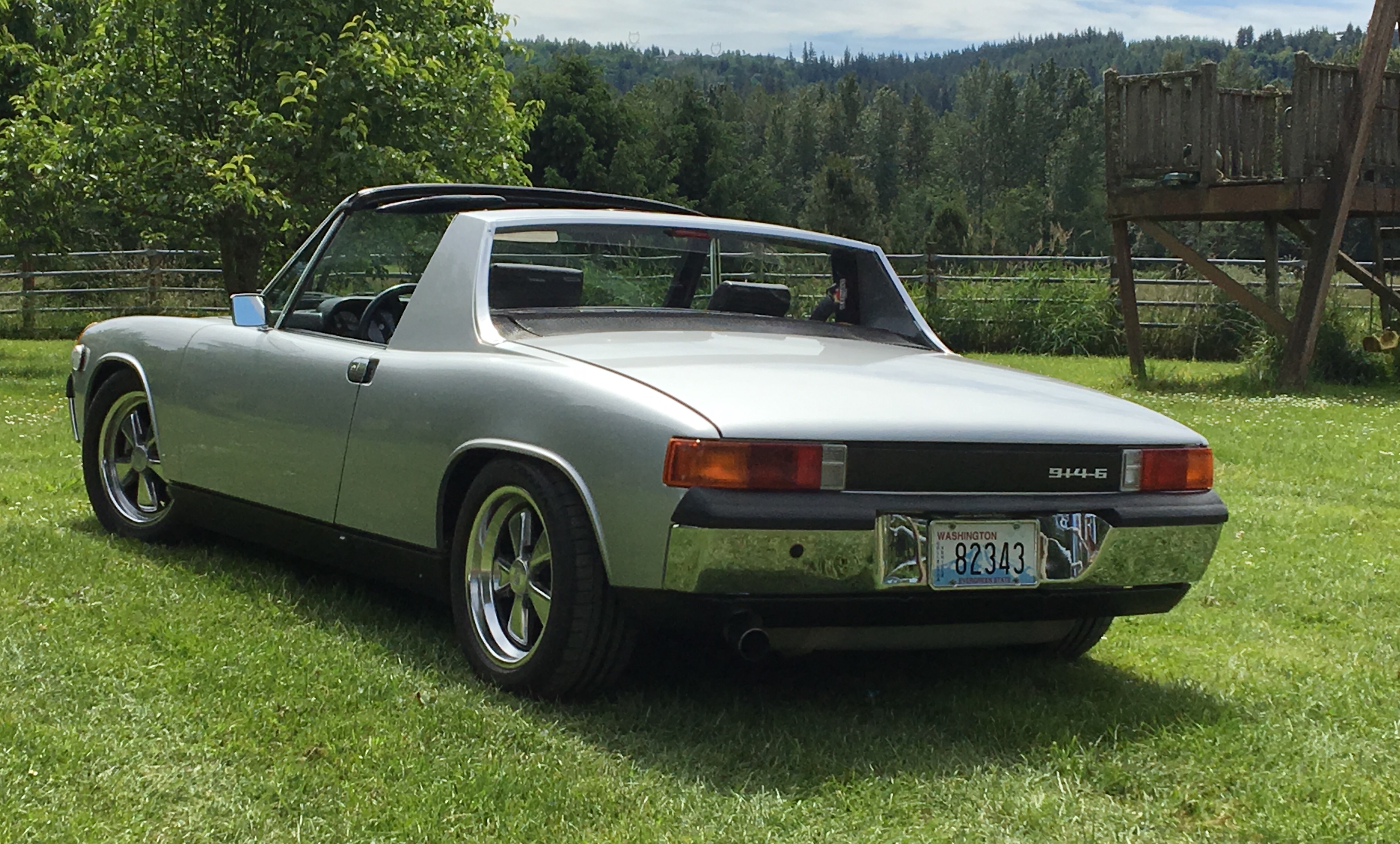

My '73 2.4S conversion narrow body hot rod is agreed value insured with Hagerty for $35K.
I'll up it to $40K next year, but how would I (or you) react if someone offered me (or you) a full $35-40K cash deal for the car, money on the barrel? Hmmm....
