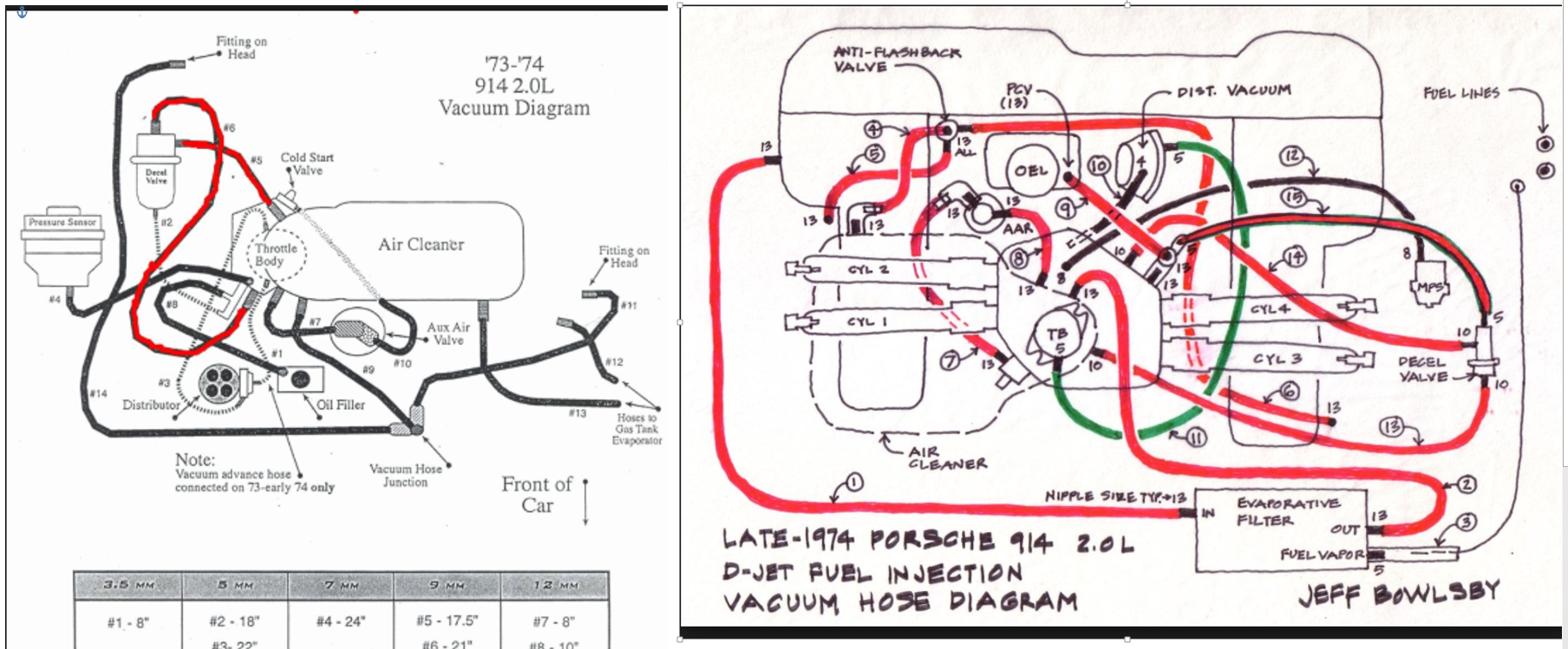

De-accl valve installed the wrong way.
ctc911ctc
post Mar 31 2019, 01:01 PM
Posts: 1,373
Joined: 9-June 18
From: boston
Member No.: 22,206
QUOTE(mgphoto @ Mar 31 2019, 12:51 PM) *
Wow - did not think about that - would it now be an Accel-valve?
Will check the plumbing of that one!
Funny, looking at these two diagrams I can see why people may get this wrong - Seems there are either 2 different types of De-accel valves or perhaps one of these diagrams is incorrect?
Help!

QUOTE(ctc911ctc @ Mar 31 2019, 02:26 PM) *
Help!

rhodyguy
post Mar 31 2019, 02:44 PM
Posts: 22,254
Joined: 2-March 03
From: Orion's Bell. The BELL!
Member No.: 378
Look closely at the stacked elbow.
