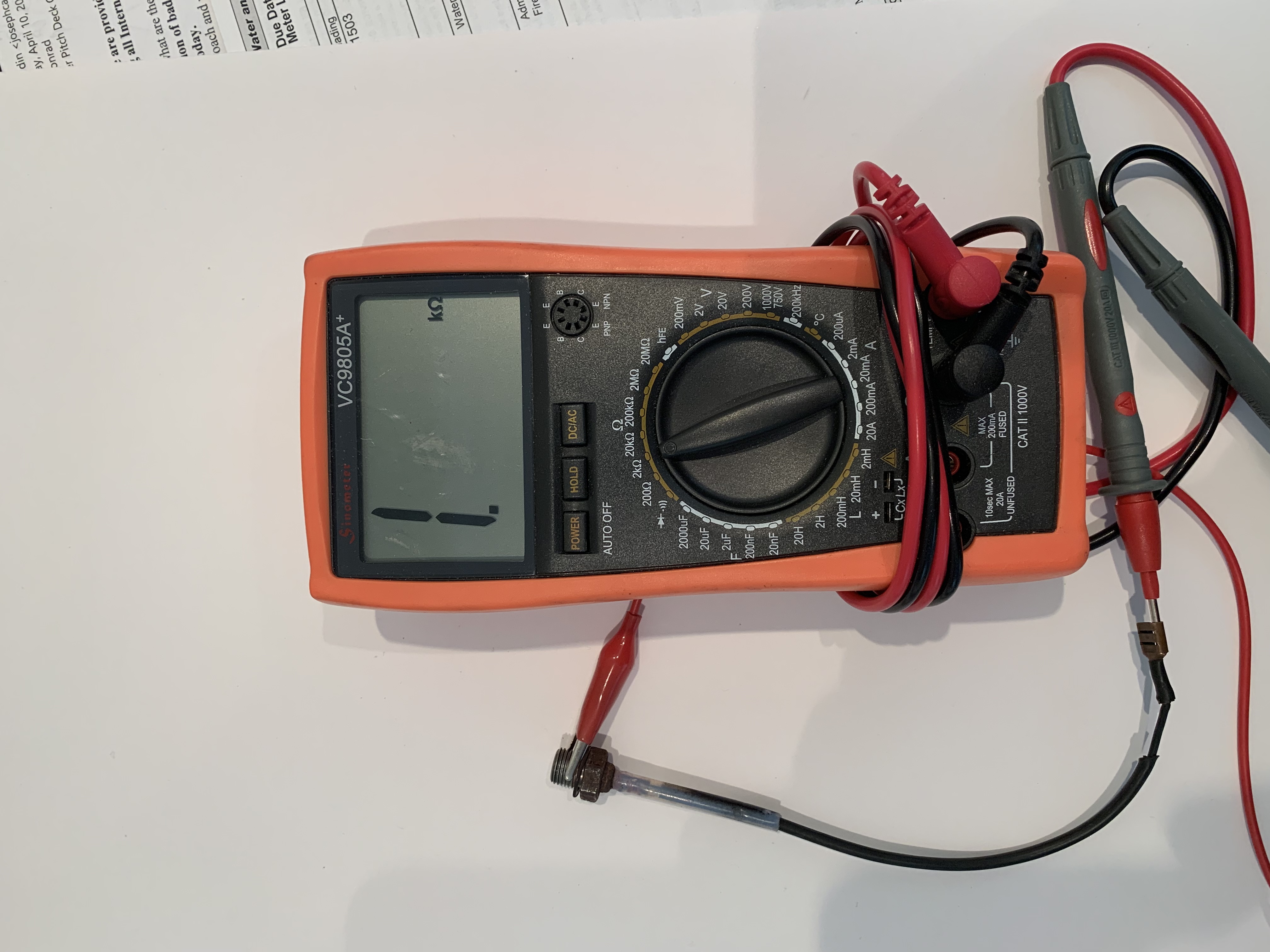

When I pulled the Plenum (chasing the too rich issue) I was able to remove the CHT. Could not get a wrench on it prior. I replaced it. As I wrote above; after I got the fixed plenum back into the car, the idle adjustment screw had no effect. This according to the all knowing Anders, is the result of a car running too lean. which also caused the popping....
So I went back to the old CHT (I had not tested it, just changed it because of it's age and it is on near everyone's list of things to replace) and I found that it was open - No Good. Ahhhh, so this could be why the car is now LEAN!!!!!
I then went to the MCU and turned the dial from the all left position (I used to be chasing too rich as the result of the CHT) to something in the middle and now the car is running at what seems to be the correct mixture. No More Popping.

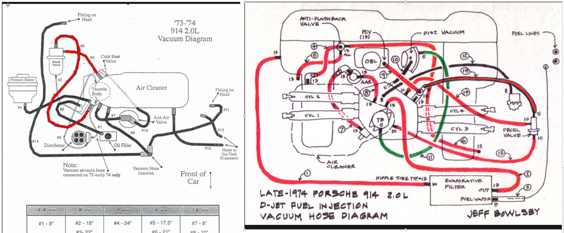

De-accl valve installed the wrong way.
ctc911ctc
QUOTE(mgphoto @ Mar 31 2019, 12:51 PM) *
Wow - did not think about that - would it now be an Accel-valve?
Will check the plumbing of that one!

Funny, looking at these two diagrams I can see why people may get this wrong - Seems there are either 2 different types of De-accel valves or perhaps one of these diagrams is incorrect?
Help!
