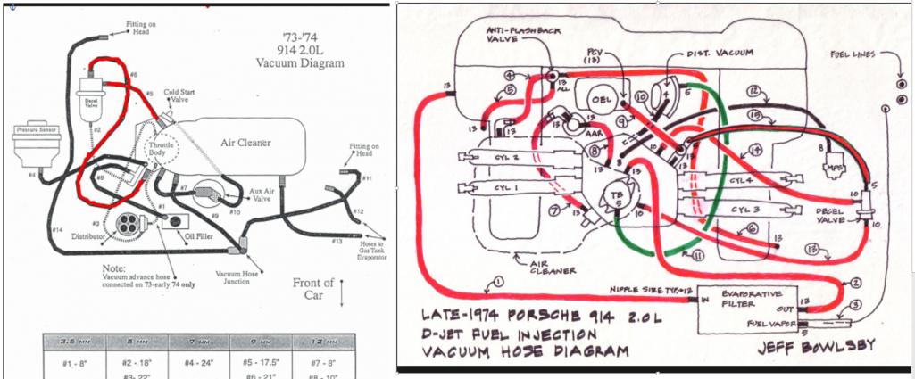

- Injectors are rebuilt with new gaskets, seem to be installed tight and correctly
- Rebuilt THrottle body
- Cannot detect any Throttle body leaks around the shaft
- New Plenum to Throttle Body gasket
- Valve adjustment
- All new hoses
- MPS holds 15in for 30 seconds +, induction is proper
- dwell is 47deg
Next Steps
Double Check timing
Remove plenum and the 4 connecting tubes
Replace gaskets and connector fabric/rubber things that are between the tubes and Plenum.
I have read and near memorized the Anders post on Rennlist, looking for any advise as to my chosen path to get this nailed.
