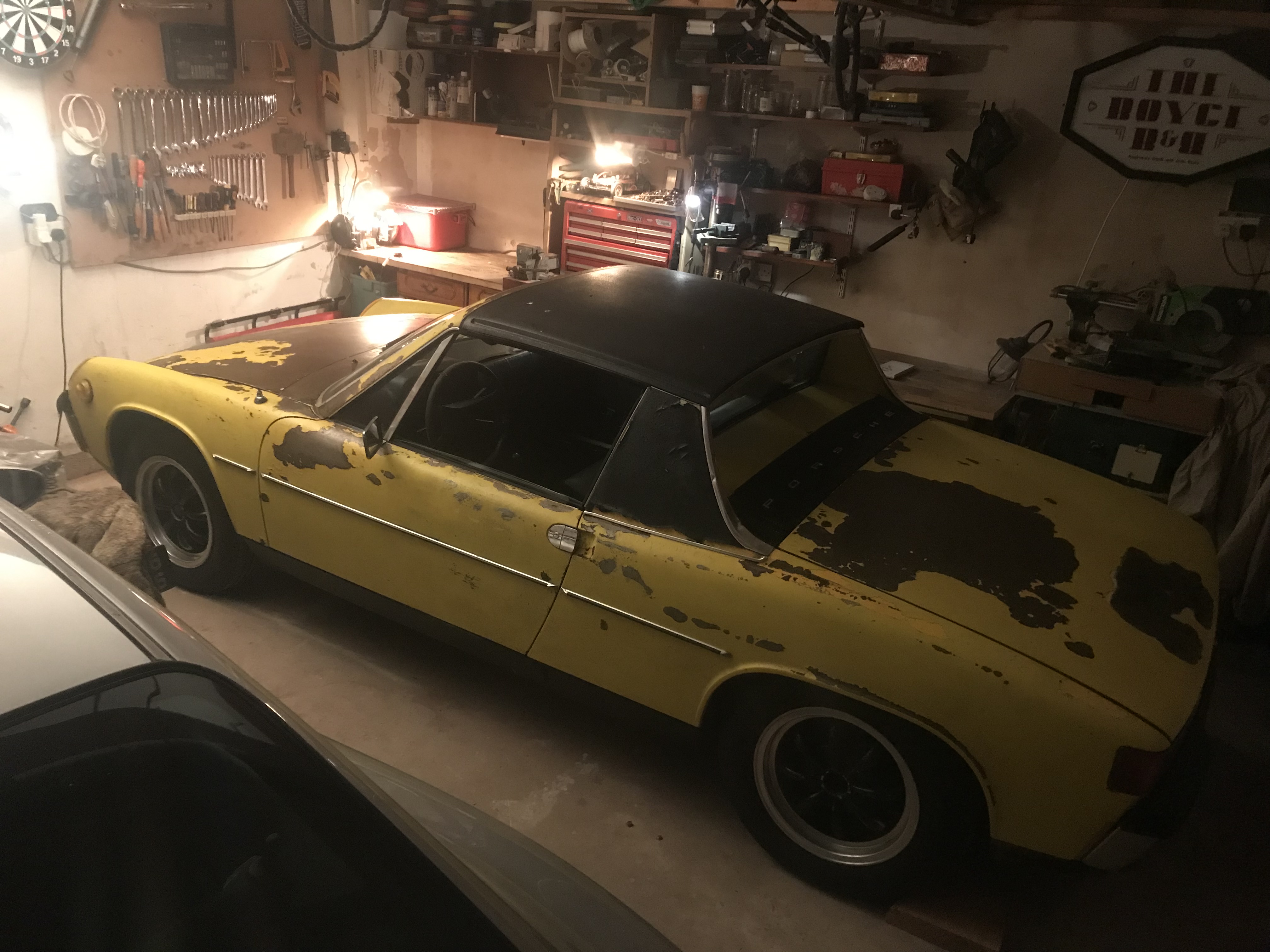

Hi all
I'm a way off yet but when I come to cutting out the rust, how do I know how much I can take before I need a chassis brace? I'm planning on a rotisserie approach which i think will mean that the chassis will be suspended from each far end, therefore putting the most leverage on the weakest spot, ie, the floor and sills. Do I just go straight for braces? It feels like that makes the most sense but wondered if anyone had any advice.
Cheers!

Yes put the brace in from the beginning. Why wouldn't you?

Brace it before you start. But I'd take measurements from the car and compare then to the factory measurements to make sure it's in spec. There's no point bracing a rusty bent car and welding in that position.
Making the relevant bracing is just a days work with the correct materials.

Bracing is the way to go. For "major" repairs, it's required. For small(er) repairs, it's a great insurance policy.
Also, while making your own is great practice (if you need practice), I prefer to spend my time doing the work. If that's your case, too, save time and get the Tangerine Racing adjustable chassis brace kit.
http://www.tangerineracing.com/tools.htm
@ChrisFoley makes great stuff! (IMG:style_emoticons/default/aktion035.gif)
Also, what @defianty said about measure first!

(IMG:style_emoticons/default/agree.gif) with all of the above. Brace before you start and use an adjustable brace so you can correct as you go. You'll be amazed how easy it is to flex the car once the longs come off.
Also, I got some really good advice when I started my rustoration to fix the structural components BEFORE putting it on a rotisserie. I built a simple frame that bolted to the suspension points so the car was supported more evenly while the structural work was being done. I sized the tubing so it could be repurposed for a rotisserie once the structural work was finished. That plan worked like a champ. Good luck!
(IMG:style_emoticons/default/agree.gif) our shop does the structural rust repair on a cellette bench before it goes on a rotisserie for finish work. If you don’t have a bench, a level table to rest the longs would be good.

Thanks so much for the advice gents!
Braces (IMG:style_emoticons/default/aktion035.gif) it is then. like the idea of adjusting the doors whilst in situ too.
