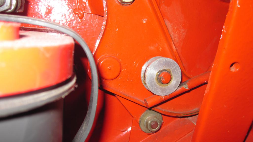

I need another metal trunk torsion bar roller, can’t remember where I got this one in the picture. Would like another one just like it. Should have bought 2 long ago. Anyone recognize it or the source?

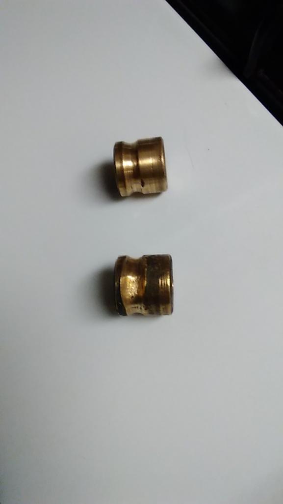

I found them.
You can see one is worn badly, PO forced on to a hinge pin that was already worn from the spring rubbing the pin directly with no roller at all.
I will probably replace the hinge before I install the plastic rollers I got from 914rubber.
Curtis, PM me a mailing address and I'll send the good one.
Thanks
Jim

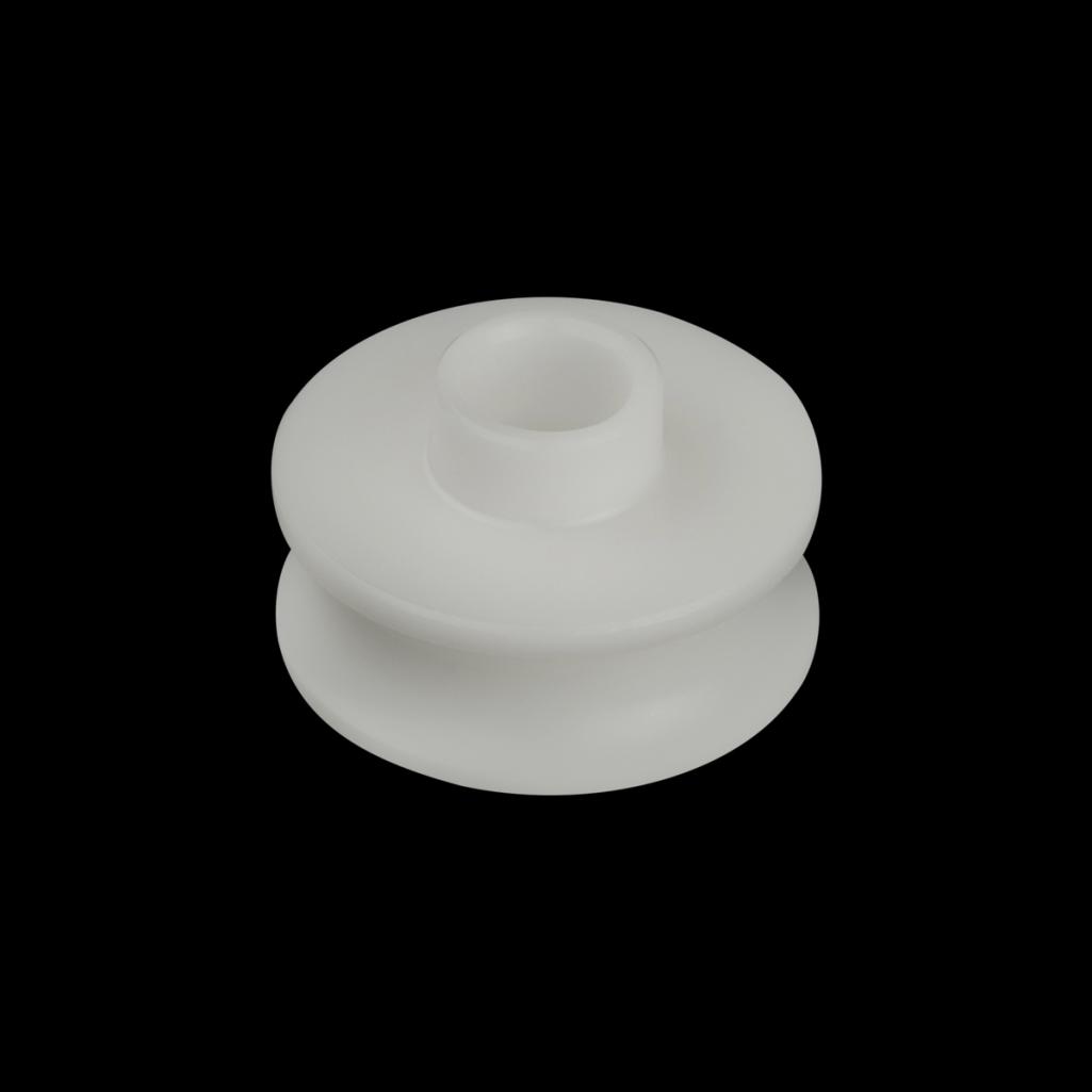

From: atlanta georgia
Member No.: 7,418
we never sold the metal ones nor brass as they wear out the trunk torsion rod. Always the delrin plastic, have PLENTY of them on the shelf at all times if you cannot find one anywhere, please make sure you install with grease and lube the shoulder bolt where it pivots on the trunk hinge to avoid a costly failure of the cup
