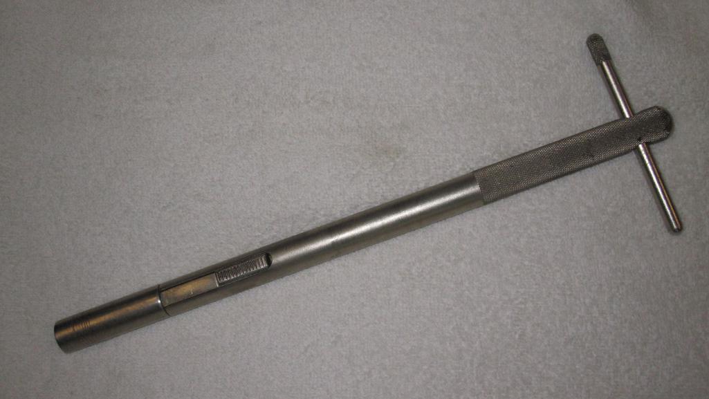

Most Koni fronts are adjustable.
Years ago I found a handy tool to adjust them in place.
The 22mm top nut is removed, the tool is threaded onto the shaft, the tool is then pushed down through the top mount to seat the shaft. At that point the shaft can be rotated for adjustment.
The tool is pictured. As I recall it is called....get this....The Adjuster.

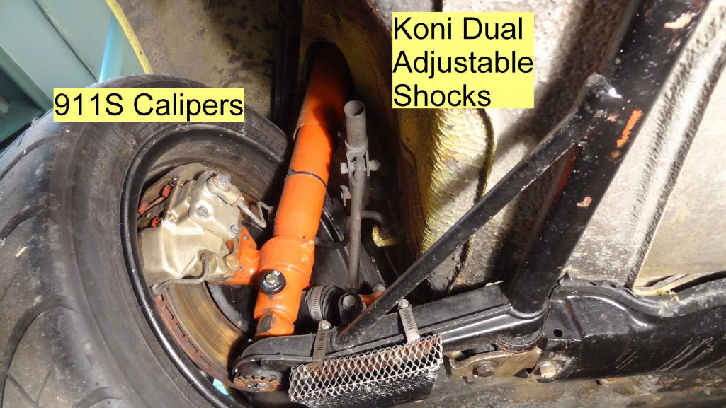

Some Koni rears are adjustable.
Pictured is the top of one version. The white knob allows adjustment in place.
There is another version that has two adjustments....known as 'double adjustable'
No longer available. Very hard to find.

Yes this is the style adjuster I have on the front, I used a small crescent wrench to adjust them to soft much better now. The rears I had to pull them, remove the springs and push the shaft to the bottom and turn to set them, all good now.
