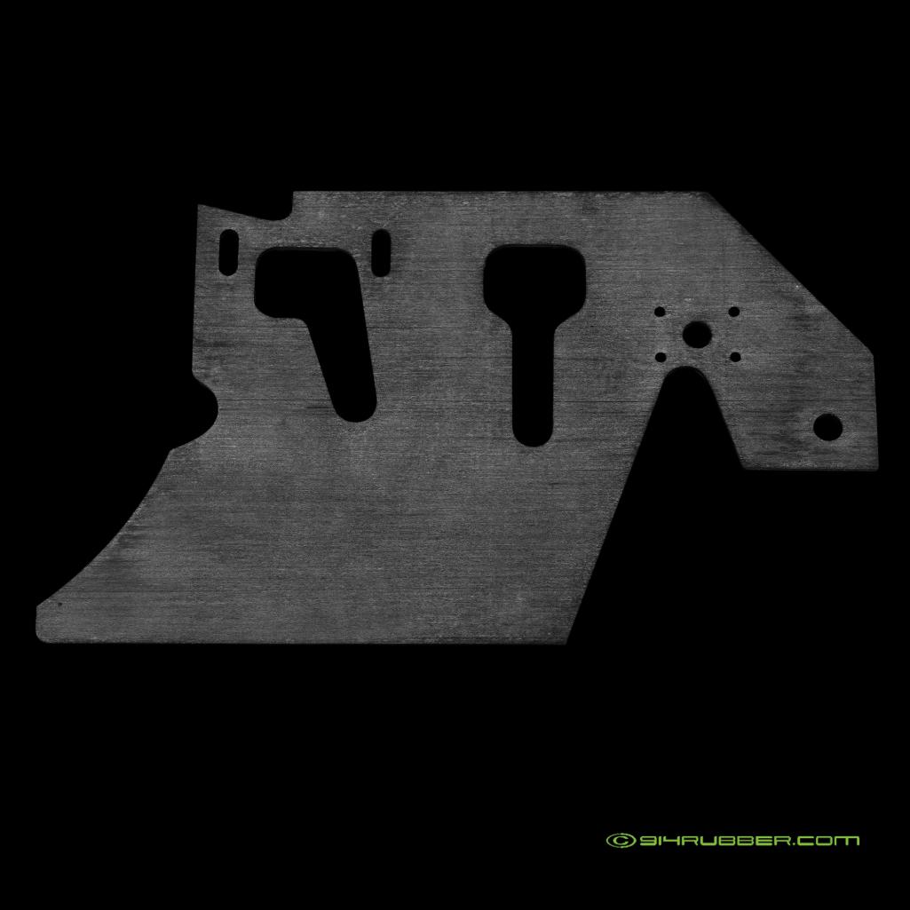

914rubber.com has marine grade plywood ones.

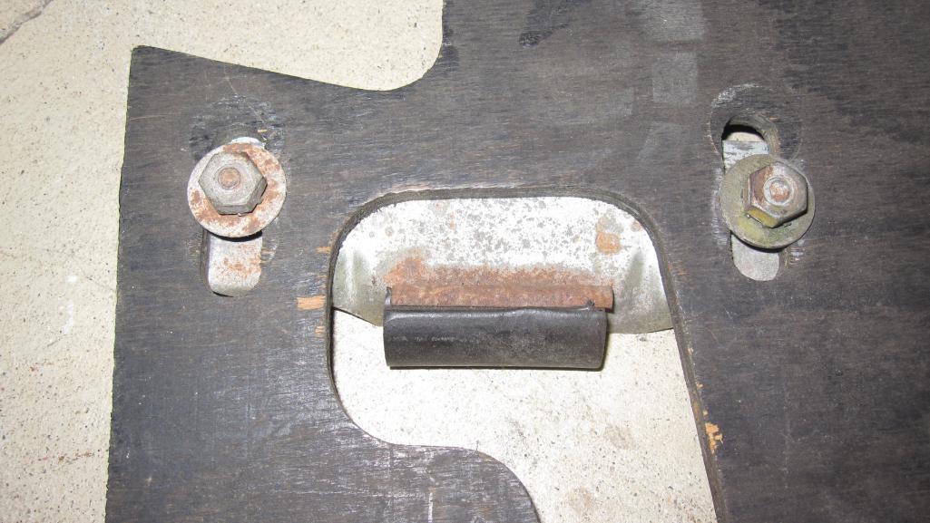

Adjustable clutch pedal stop

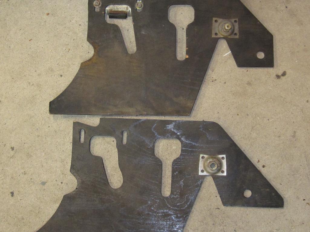

I just noticed different versions of wood toe boards.
notice the right side and the pedal slots

I the top one is a later version as the foam cavity that was added for the EGR counter. We make that style as it’s a universal fit.
We even stain them
https://900designs-container.zoeysite.com/p...l-floor-board-1

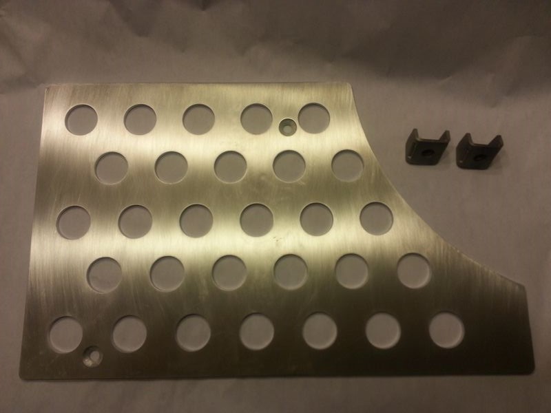

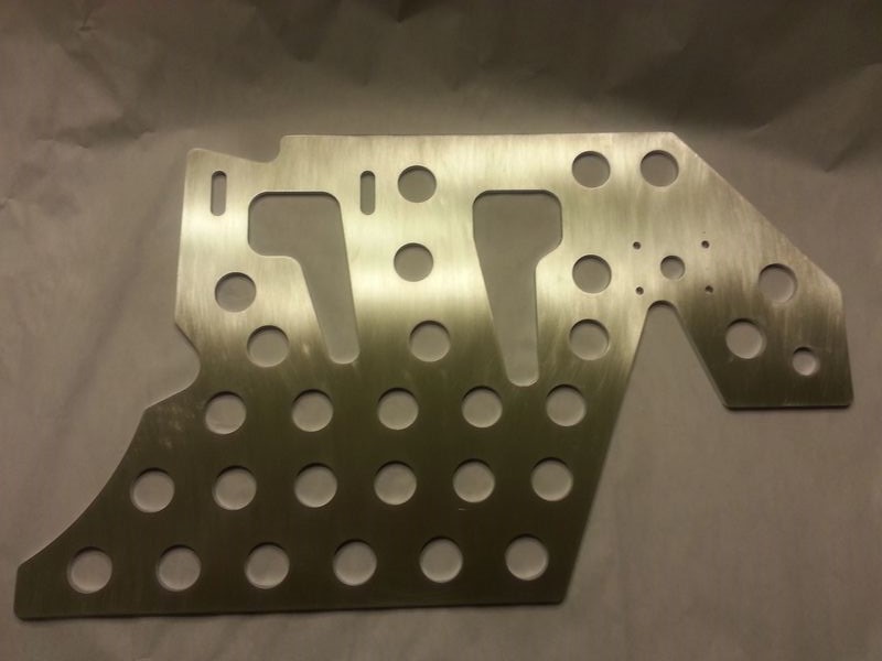

Various vendors have offered aluminum pedal boards. Maddogsmotorsports has these:
https://maddogsmotorsports.com/914-accessories

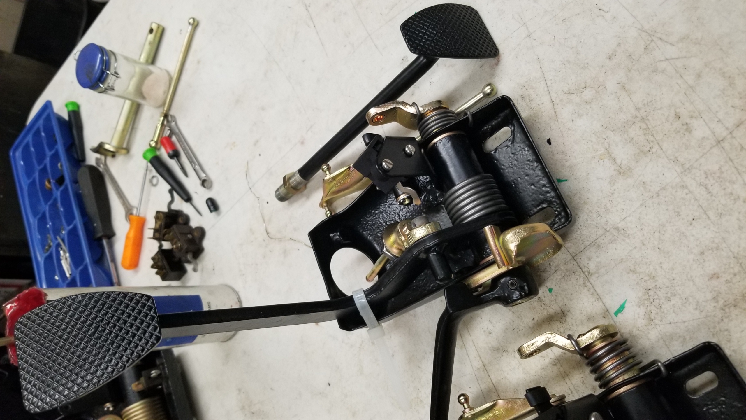

No need to remove the cluster. loosen the clutch pedal stopper (if u still have it) from the clutch hole of the board. then try to remove the clutch pedal 1st out of the board then just twisting the board while trying to remove the board out of the brake pedal.

No, you just work it over the pedals. Pull the rod out of the back of the accelerator pedal to give some extra space.
