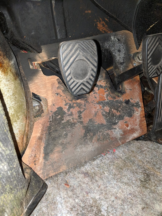

I'm new to Porsche and have only been reading about them since I bought the 914 about a year ago. While tracing a brake pressure warning wire I have fallen into the rabbit hole and found a wooden pedal plate. Seems like it should be made of metal. Is wood okay here?
Spoke
The pedal board is not metal. I think it may be wood or some type of wood-like material.
rgalla9146
On the drivers side it is thin (5/16" ? ) plywood painted black.
It would have an adjustable throttle stop mounted to the right and an adjustable
clutch pedal stop to the left.
Your picture shows a homemade item.

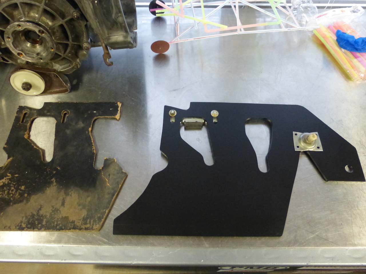

Early up to 73 the pedal boards were plywood. Later were a thick fiberboard. Both did not hold up well.
They are important for the clutch and accelerator stops
914rubber.com has marine grade plywood ones.

I recent one.
