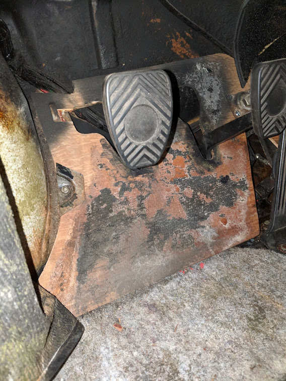

I'm new to Porsche and have only been reading about them since I bought the 914 about a year ago. While tracing a brake pressure warning wire I have fallen into the rabbit hole and found a wooden pedal plate. Seems like it should be made of metal. Is wood okay here?

The pedal board is not metal. I think it may be wood or some type of wood-like material.
rgalla9146
post Apr 21 2019, 06:50 PM
Posts: 4,954
Joined: 23-November 05
From: Paramus NJ
Member No.: 5,176
On the drivers side it is thin (5/16" ? ) plywood painted black.
It would have an adjustable throttle stop mounted to the right and an adjustable
clutch pedal stop to the left.
Your picture shows a homemade item.

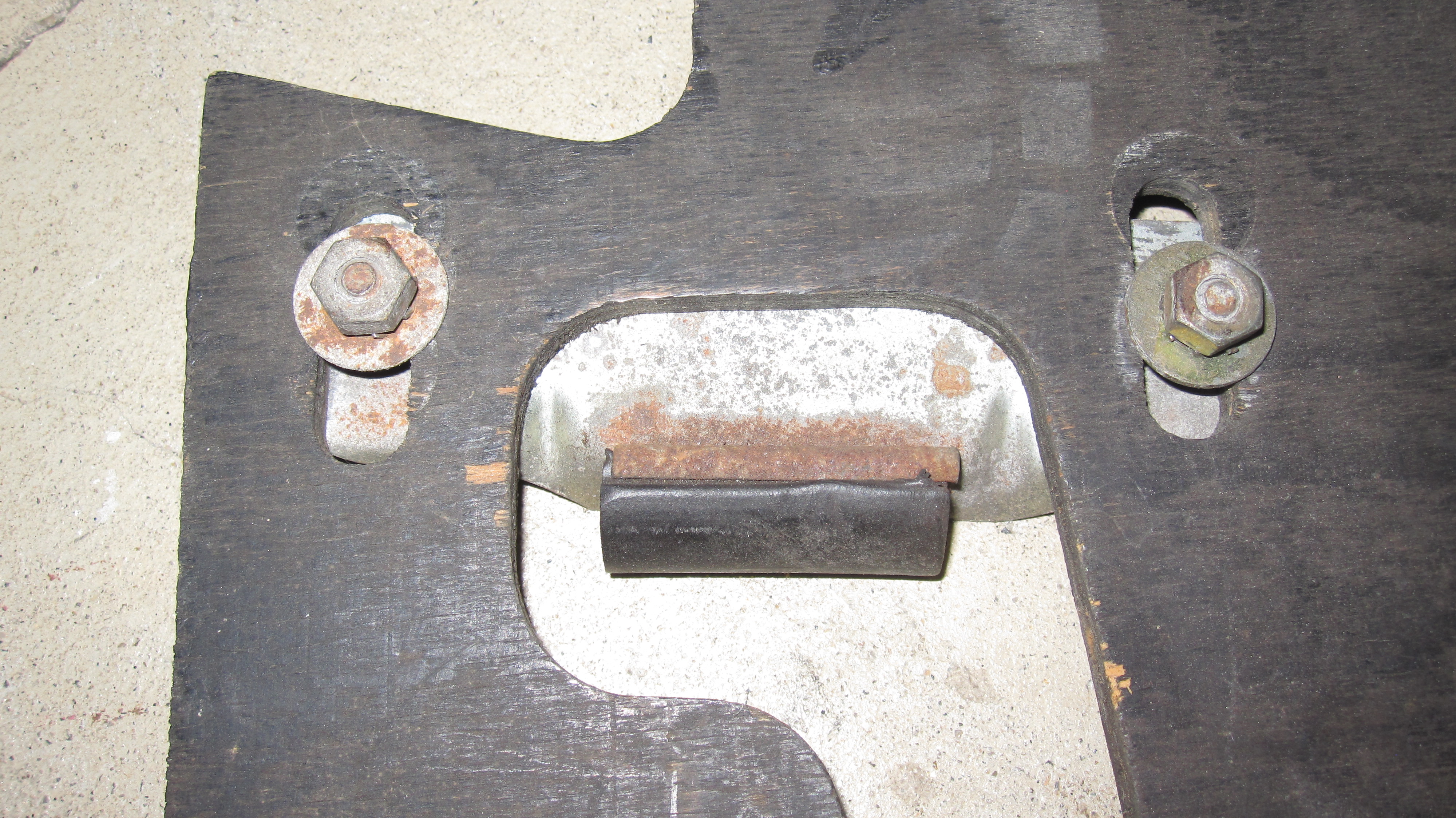

Can someone post a picture of the clutch pedal stop?? My car does not have one. TIA

QUOTE(michael7810 @ Apr 22 2019, 10:19 AM) *
Adjustable clutch pedal stop

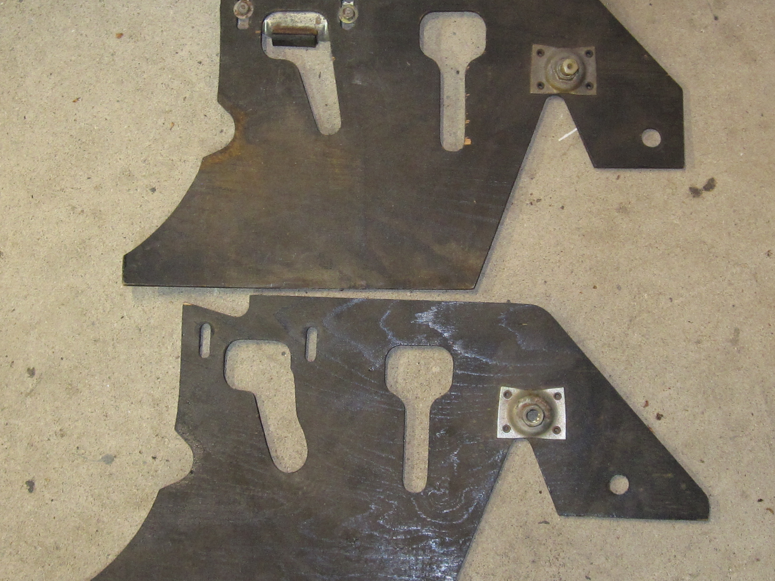

I just noticed different versions of wood toe boards.
notice the right side and the pedal slots

I the top one is a later version as the foam cavity that was added for the EGR counter. We make that style as it’s a universal fit.
We even stain them
