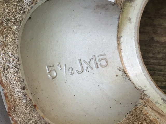

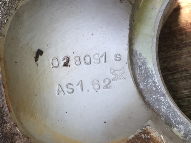

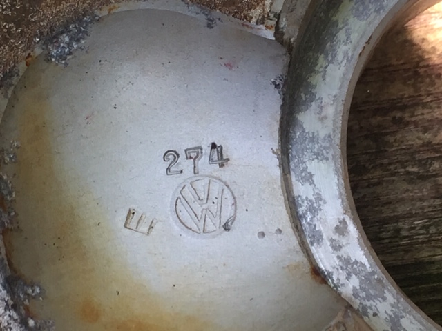

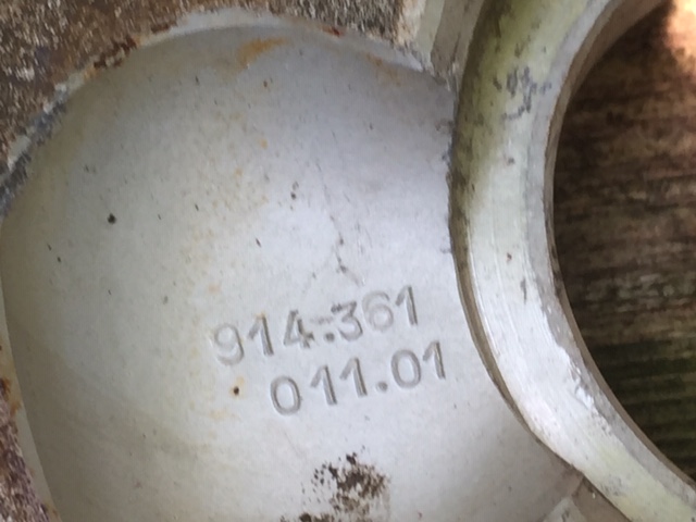

Hi All - I'm having a little problem with these center caps myself. It seems like the fronts and the rears are different size holes. Fronts are about 60mm and the original Porsche part number 914.361.303.07 fits, but the rears seem to be 62 or 63MM. These caps absolutely don't fit, but I haven't found any different types that are listed at anything other than 60mm.
Has anyone else run into this?

If the holes sizes in your wheels are different front to rear then you have a wheel issue not a cap issue. The wheels should be the same front and rear.
Jim
Jim
(IMG:style_emoticons/default/agree.gif) You either have a pair of reproduction wheels or the originals have been altere.
Thanks, guys. That's kinda what I was afraid of. I'll have to do some more digging.

They should look like this.
