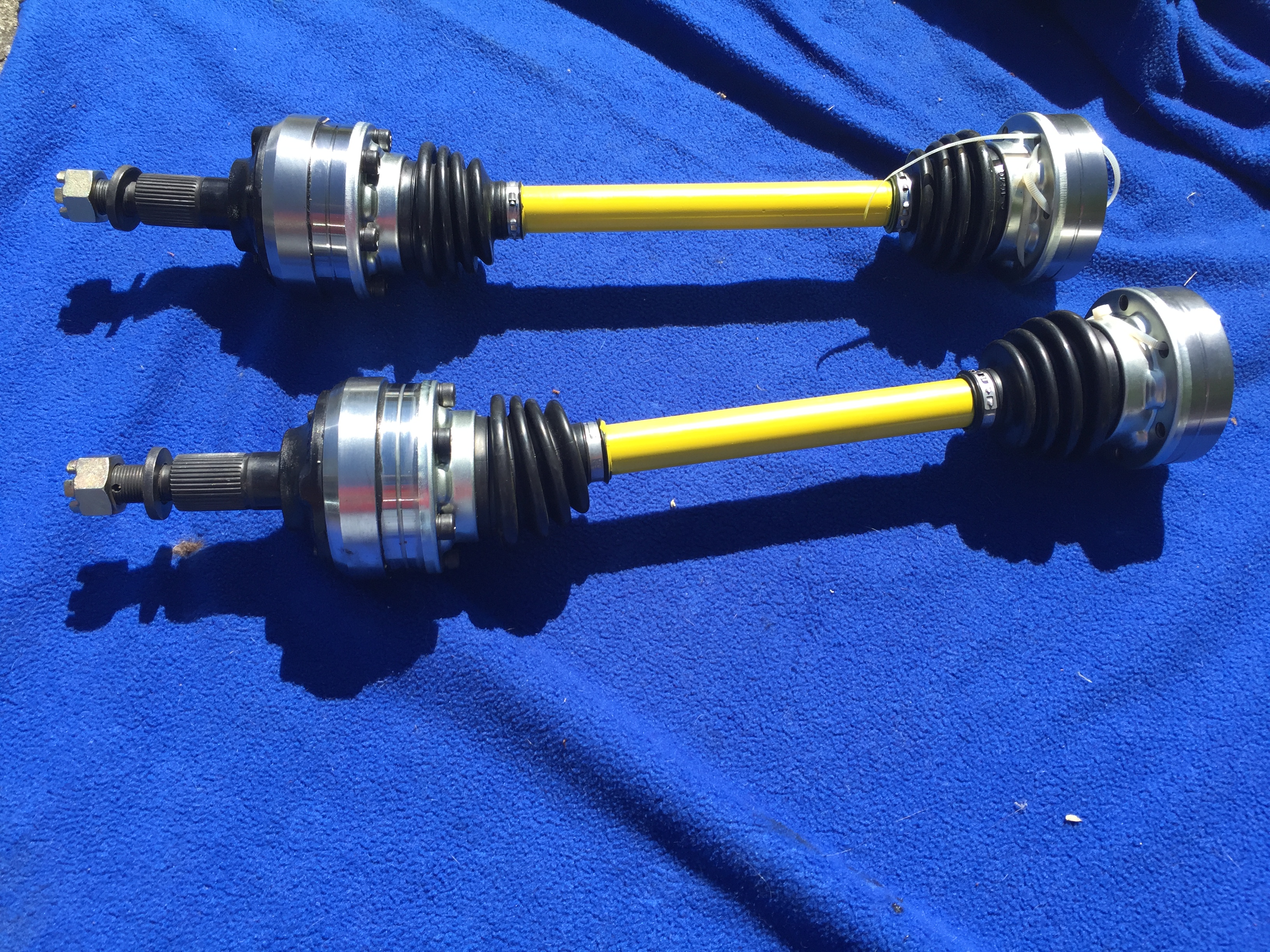

Ok my opinion is worth crap. But I have these in my big 4. Overkill? Without a doubt. But with these you just don’t have to worry about anything breaking. To me it was wortgythe money.

QUOTE(Mblizzard @ May 8 2019, 01:48 PM) *
(IMG:style_emoticons/default/agree.gif) no need ,stock stuff in good condition is fine,enjoy your car by spending elsewhere like brakes for example....and other area's (IMG:style_emoticons/default/beerchug.gif) .

Don't own stock in the company so this is just my opinion. Spend you money wisely but in the case of axels and most drive train parts, if its worth doing, its worth over doing!
These are extremely well made and you will never have to replace broken parts. For me after I dropped a CV joint and destroyed a SS heat exchanger, oil cooler, and head it was a no brainer to upgrade them even if I did not have 200 hp.

which company did those yellow axle's Mblizzard
Andyrew
post May 8 2019, 04:32 PM
Spooling.... Please wait
Posts: 13,381
Joined: 20-January 03
From: Riverbank, Ca
Member No.: 172
Looks like renegade adapters
Mblizzard
post May 8 2019, 05:47 PM
Posts: 3,033
Joined: 28-January 13
From: Knoxville Tn
Member No.: 15,438
QUOTE(flmont @ May 8 2019, 01:41 PM) *
Renegade just painted them yellow for effect.
