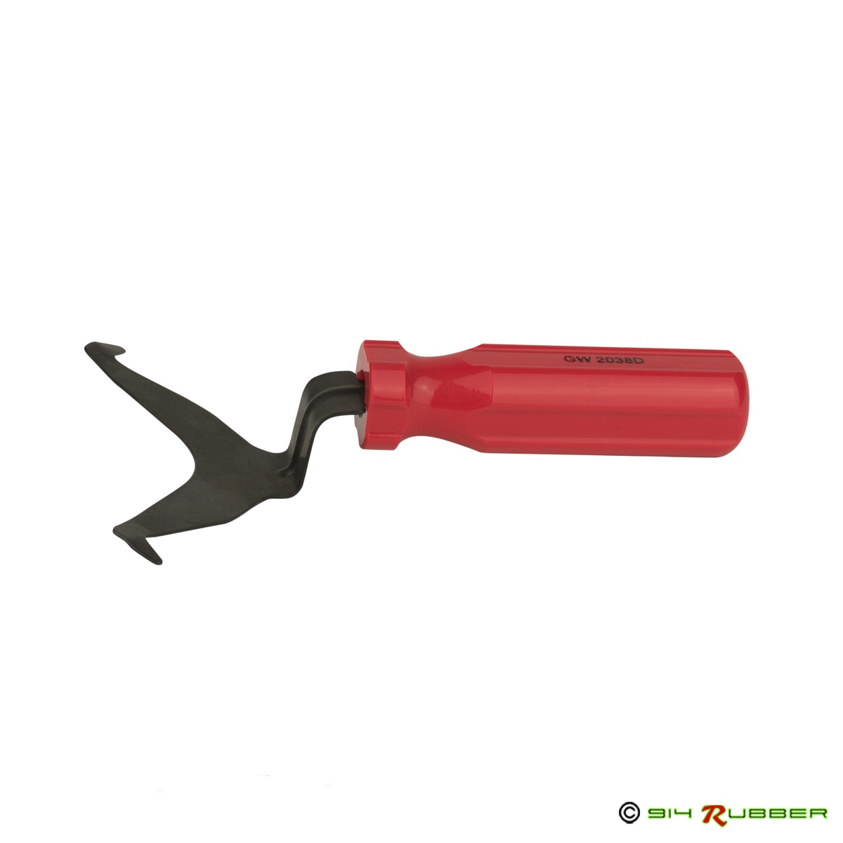

We do stock the trim removal tool if you need it and the new improved version of the clips.
https://900designs-container.zoeysite.com/w...-removal-tool-1
